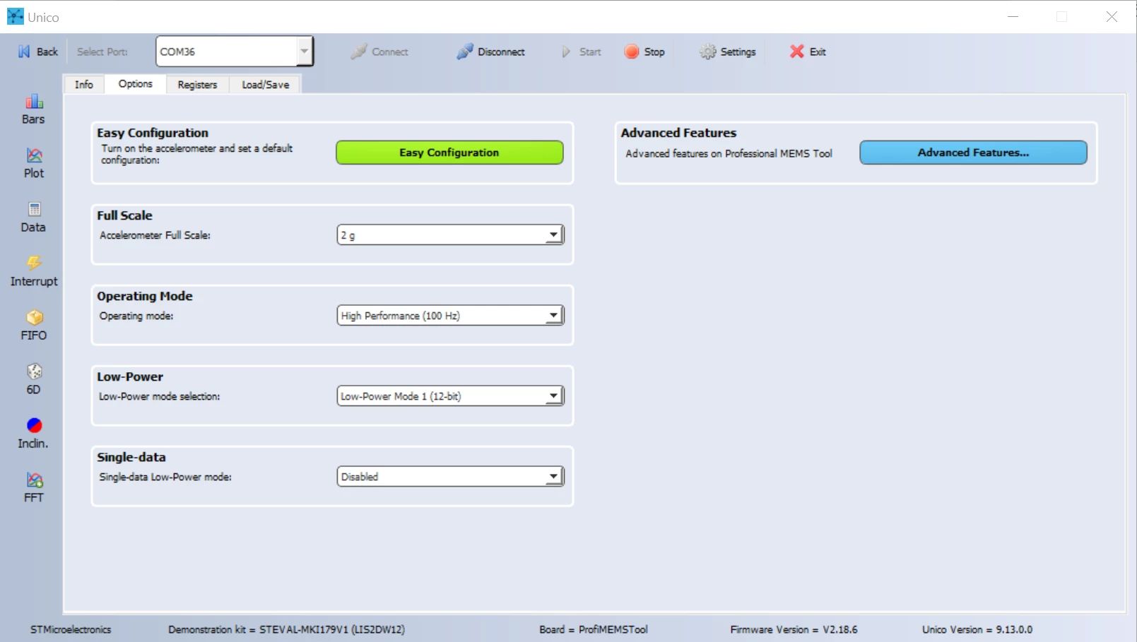

By the way, I have posted another issue on the web case 00167097:
I have downloaded the UNICO GUI software to develop an apps using the accelerometer ref = LIS2DW12 with the STEVAL-MKI109V3 (Professional MEMS tool).
When clicking on the <Advanced Features> in option tab , the "current supply measurement / power supply" window does not pop up. No way to measure the current which is the basics.... Moreover, it enters in an never ending loop with UNICO is not responding !
Could you help on that one ?

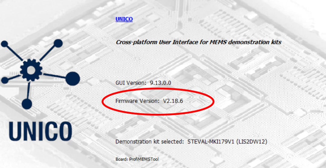

coming back to FW version: I have V2.18.6 coming with download of GUI UNICO V9.13.0.0.
Is it correct?
In the UM1049 I read 3.30.0

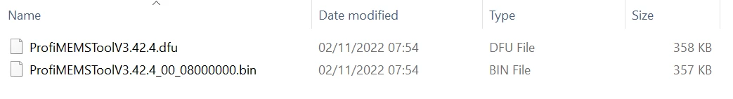

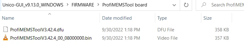

the associated Unico FW should be the v 3.42.4 version
0693W00000VOqDxQAL.png-Eleon

Yes , I have the V3.42.4

And did you uploaded it on the ProfiMEMS?
LCari.1
LCari.1Author
November 4, 2022
Eventually I have updated , more than painful, the STEVAL-MKI109V3 (DFU) and now the FW rev = V3.42.4 is installed. I can see the correct rev on UNICO GUI and everything works fine.
My point: I don't understand why downloading the last rev of UNICO GUI from the website then lauching the corresponding .exe there is no automatic check on the STEVAL board of its current implemented FW rev to see if there is a match....
Any comment ?

The interface has many less tabs and options than the on described in the UM1049
Eleon BORLINI
November 4, 2022
It should be related to the fact that you are using a pure accelerometer, the LIS2DW12. On this device, differently for example from 6-axis IMUs (e.g. LSM6DSOX), you don't have digital features such as the FSM, the MLC, etc...
