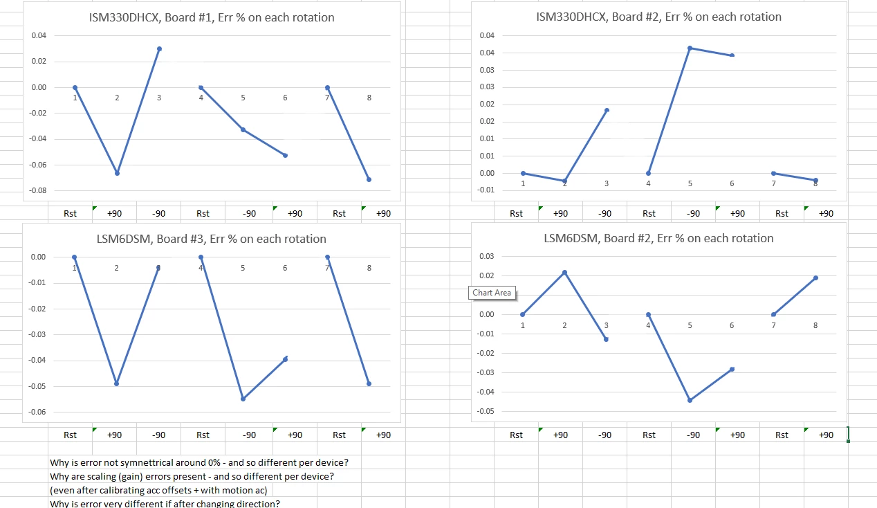

SLibe
SLibeAuthor
March 8, 2021
Hi @Eleon BORLINI​ ,
  • The accelerometer offset correction is now implemented (via X_OFS_USR/Y_OFS_USR/Z_OFS_USR registers)
  • The MotionAC accelerometer calibration is also now implemented.
  • As suggested, we have run testing on 4 different devices from our production line: 2 boards using ISM330DHCX, 2 boards using LSM6DSM
  • As detailed further in the test results below:
    • The addition of accelerometer calibration has not changed the fundamental issues, which are:
      • Apparent scale factor (gain) error, which is a different magnitude on each board
      • Non-symmetrical error, when rotating in first one direction, then the opposite direction, which is a different magnitude on each board - suggesting bias error
      • Different amounts of error on the second rotation (i.e., after changing directions in a single run)
The attached graphic summarizes the types and differing amounts of error in each board. All error values are averages of 7 separate runs. Each graph has one point for each of these 5 steps in the test:
1) Reset board, Rotate 90 degrees (Right), acquire MotionFX yaw angle measurement
2) then, Change Direction ("cd"), rotate -90 degrees (Left), acquire MotionFX yaw angle measurement
3) Reset board, Rotate -90 degrees (Left), acquire MotionFX yaw angle measurement
4) then, Change Direction ("cd"), rotate 90 degrees (Right), acquire MotionFX yaw angle measurement
5) Reset board, Rotate 90 degrees (Right), acquire MotionFX yaw angle measurement. This verifies repeatability of step 1).
Ideally, all lines in these graphs should be flat (0 degrees error no matter which rotation is made or if directions are reversed).
Detailed test data and summary are in this Excel Spreadsheet, this includes for each board details about data/fusion rates, output data rate, full-scale range, etc.
Please let me know what are some additional factors that can be causing this.
(a) Is it possible that the zero-rate offset calibration performed by MotionFX is not working correctly?
(b) Why should we see different error amounts for rotations occurring initially after reset, vs, rotations occurring after changing direction?
Thank you for any expertise you can provide to help us solve these issues.
  • scott
P.S. Test Conditions are documented in the Excel spreadsheet.
Eleon BORLINI
March 9, 2021
Hi Scott,
not many further suggestions, indeed...
Can you try with changing the ODR (lowering it from the 416Hz current value?) it might be that a too fast ODR is worsening integration errors in time.
In ST algorithm lower ODRs are sometimes used...
-Eleon
