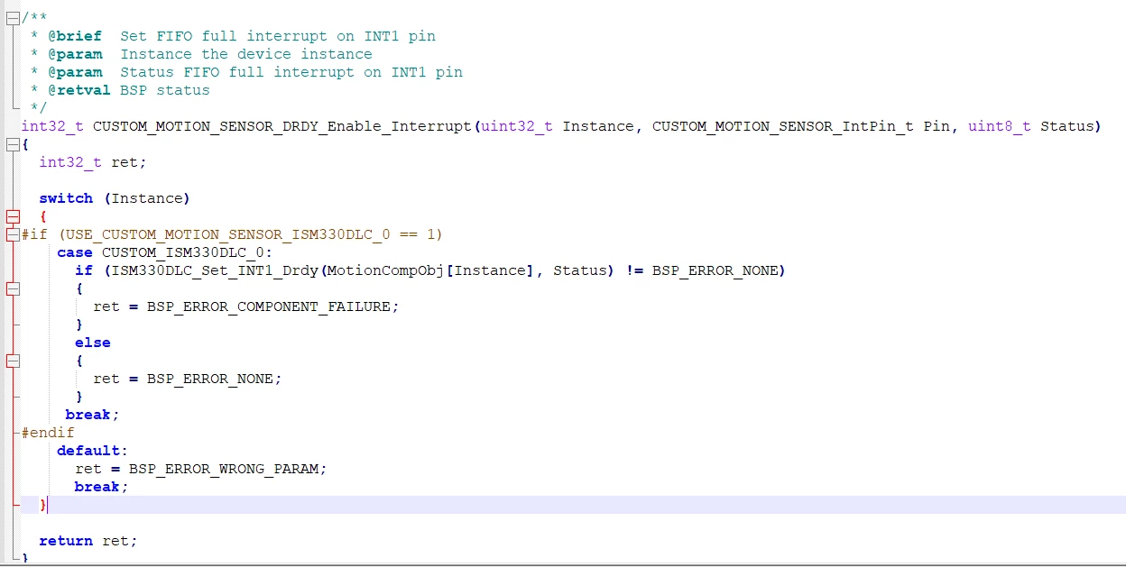

Using STM32CubeIDE(1.7.0),had project with older version of "X-CUBE-MEMS1" package. Found that APIs CUSTOM_MOTION_SENSOR_DRDY_Enable_Interrupt()" and "CUSTOM_MOTION_SENSOR_DRDY_Set_Mode()" definitions are missing in latest version(9.1.0). Support to

Seenu
SeenuAuthor
March 8, 2022
Hello @parata.carlo​ ,
Thanks for the response.
Old version used for X-CUBE-MEMS1 : 8.1.1
Shall we have the same/similar APIs to handle the feature intended.
Please support.
Best regards,
Seenu

Seenu
SeenuAuthor
March 15, 2022
Sorry, the package X-CUBE-MEMS1 v7.2.0 version has the both definitions in MEMS\Target\custom_motion_sensors_ex.c.
Kindly find the attachments for more details.
Help me if i can continue using the old versions of package or new version has these definition feasibility.
Best regards,
Srinu

Seenu
SeenuAuthor
March 24, 2022
Thanks for the suggestion.
Now made application separate from the existing library.
The two functions - CUSTOM_MOTION_SENSOR_DRDY_Enable_Interrupt()" and "CUSTOM_MOTION_SENSOR_DRDY_Set_Mode()"
made part of application code.
Best regards,
Srinu
