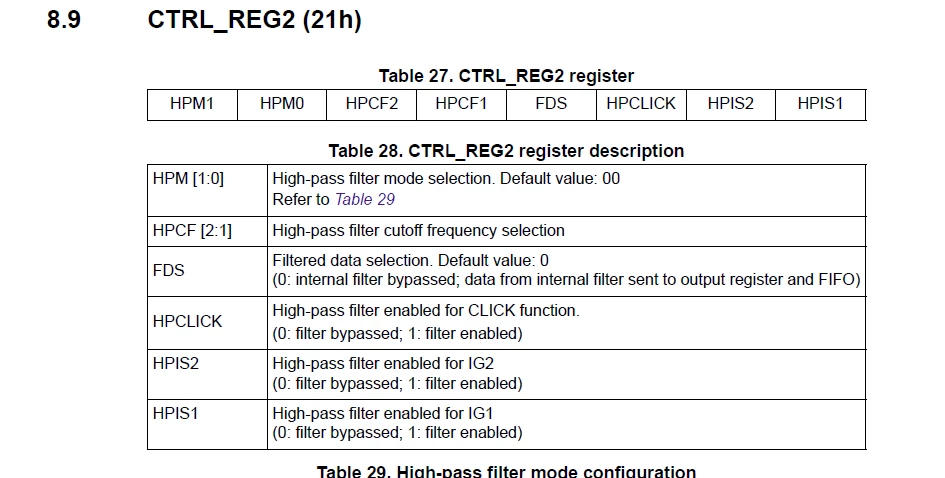

The purpose is to detect the car accident while ignore the normal acceleration variance during car driving.
I know there is a high pass filter in the lis3dx sensor, and the cut-off frequency can be changed by setting the following register (with actual cut-off frequency related to ODR setting) but don't know how to choose the best value. I guess there is experience value for the ODR and HPCF settings in car application. Anyone have relevant experience and would like to share it with me?

The real-time quality of the accident detection in my application is not that critical so no question about that. It's a product that help mark the video taken by the camera in case of car accident. Yes, a car rolling over a roof is definitely a car accident but it still can be detected by the lis3dx sensor even if the high pass filter is applied, can't it?
The reason I'm asking about the high pass filter setting is because the high pass filter can help attenuate the acceleration signals generated in normal car driving which is rather gentle in most cases. Also high pass filter can help remove the dc components.
I also find with the same threshold and duration setting, the lower HPCF setting can cause the interrupt trigger more easily in case of normal car driving. I deduce that the lower HPCF attenuate the signal generated in normal car driving less and cause the interrupt trigger easily.
