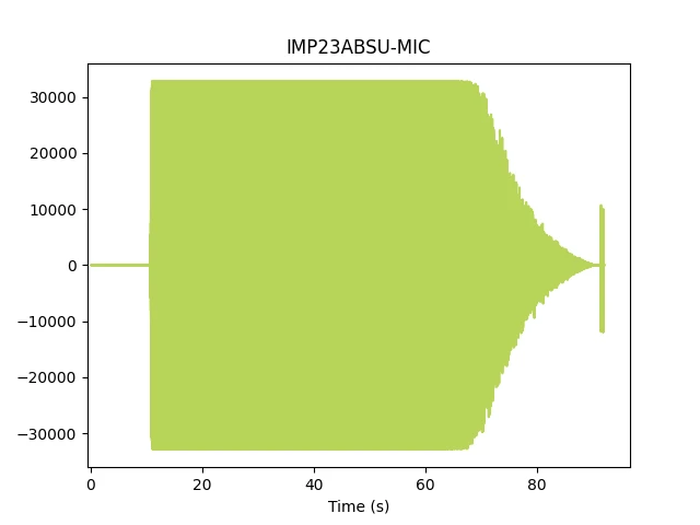

Thanks for the reply! I have plotted the measured raw data and started analysing it where it looked like if i had peaks at 30000 dB (Y-Axis)? Can it be that i must normalize the Y-Axis by some factor? Is there any documentation for this? IMP23ABSU-MIC_hsdatalog_plot.png
Federica Bossi
November 6, 2023
Hi @TomRett ,
Sorry, looking closer, the data go from -32000 to +32000 so they are in LSB over 16 bits, and it seems they cover all the dynamics up to full scale, which is 130dBSPL, or 0dBV, or 1V (because 94dBSPL = -38dBV).
If you want LSB in volts, you have to do 1V/32.768 = 30uV
If you want it in dBV, LSB(dBV) = 20*log(1V/32.768)
With the conversion factor above you get dBSPL, which is directly related to Pa.
