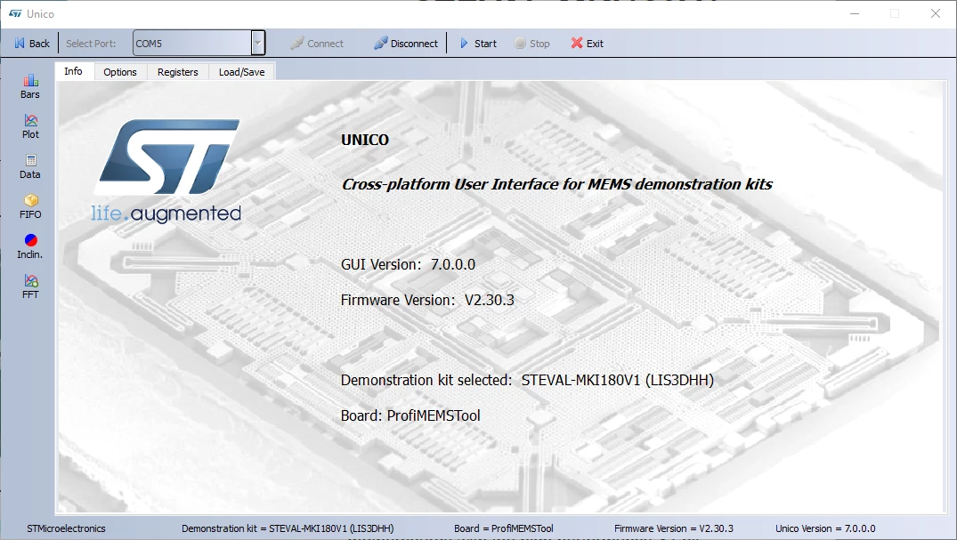

​I am working with STEVAL-MKI109V3 and STEVAL-MKI180V1 (Lis3d). After finally getting the drivers and firmware etc. sorted so that the device is recognised by Unico, it seems now that Unico is not showing the complete set of tools: in particular I am missing the interrupt tool. Any ideas on how to get this to show up? I am attaching a screenshot of my Unico - note that the interrupt (and some other tools) are missing on the left hand side.
Unico GUI Version 7.0.0.0
Firmware Version V2.30.3

The interrupts are not supported in current version of Unico.
Interrupt window is usually used for threshold interrupt, free fall detection, ... these features are not available in LIS3DHH so this window is not available in Unico.

​Hi Miroslav,
thanks for your quick reply.
I am not sure I understand correctly: Unico does not support this at all? is there a different version of Unico that does support interrupts?
Also, do I understand you correctly that even though the LIS3DHH has 2 interrupt pins (see attached datasheet), they are never used? Can they be used in any way?
If the problem lies with the LISDHH, are there other accelerometer evalboards that have the intterupt functions? I wanted to test postential threshold values to later be used with a LIS3DHTR, can you recommend anything to be used here?

​Postscript:
Say, if I used a STEVAL-MKI105V1 (https://www.st.com/content/st_com/en/products/evaluation-tools/product-evaluation-tools/mems-motion-sensor-eval-boards/steval-mki105v1.html) instead of the STEVAL-MKI180V1, which has the 'complete LIs3DH pinout' according to its data sheet, would I be able to set and read out the interrupts with Unico?
