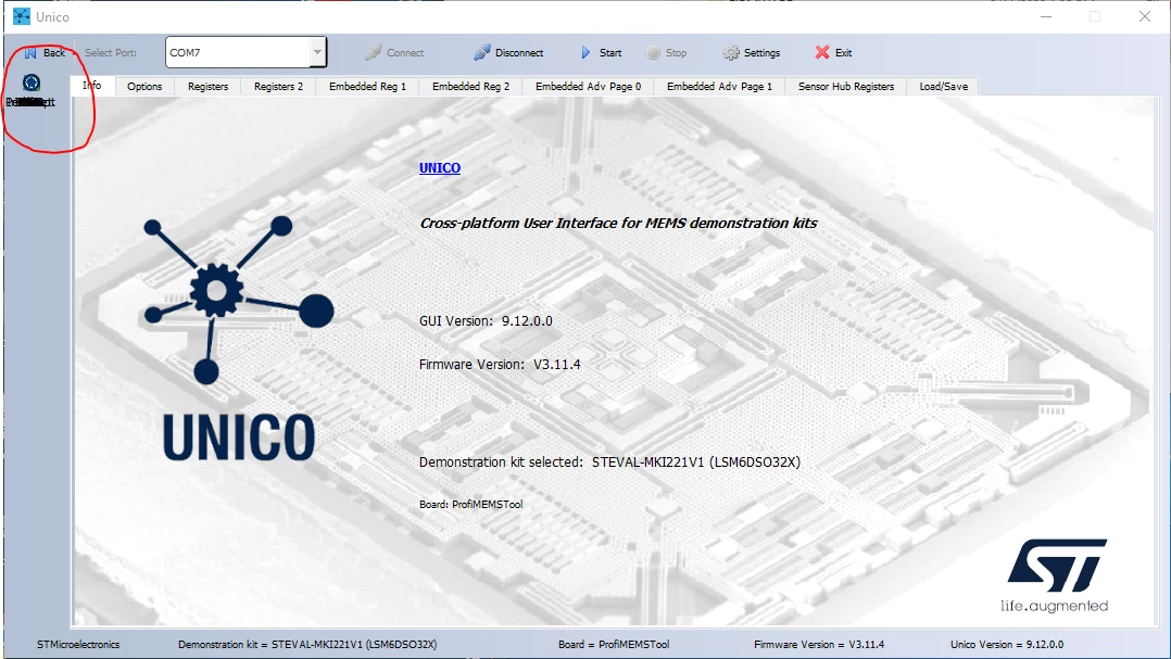

Unico-GUI tools bar - icons showing up on top of each other
Well, the Unico-GUI software was working fine, and one day all of the tools (bars, plot, data, etc) started getting drawn on top of one another, and the last one (pedometer) is the one on "top" and the only one I can now select. Any idea how to fix this? I uninstalled/reinstalled and it's still doing this...
0693W00000SucYeQAJ.pngBrian
    Brian Rau
    Brian RauBest answer
    September 6, 2022
    My solution: Uninstall Unico-GUI, reboot the PC (Windows 10), then re-install from scratch. That fixed it. An uninstall/reinstall without the reboot didn't.

    Eleon BORLINI
    September 6, 2022
    Hi Brian @Brian Rau​ ,
    Did you changed the Operating System in the meantime?
    And do you see same issue starting Unico "offline"?
    -Eleon
    Macneacail
    September 6, 2022
    it is annoying I will grant you that, but it usually goes away on a restart the program.
