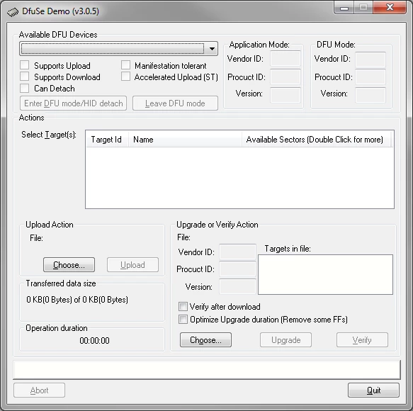

Jared Hagel
February 21, 2018
Posted on February 21, 2018 at 18:54
Hi Miroslav. We have the
STEVAL-MKI109V1 evaluation board. I've followed the instructions on updating the FW in the board, but I don't see our device in the 'Available DFU Devices' drop down menu shown below. From reading the DFU documentation it's not clear to me how to get our
STEVAL-MKI109V1 evaluation board into DFU mode. Do you know how this is done? We might just buy the latest evaluation board for LIS3DH since our evaluation board is obviously quite old.
February 21, 2018
Posted on February 21, 2018 at 21:12
The STEVAL-MKI109V1 in no more supported, you will have to buy
STEVAL-MKI109V2 or STEVAL-MKI109V3.
I will double check if there is way how to make STEVAL-MKI109V1 functional, but chance is small.
February 23, 2018
Posted on February 23, 2018 at 11:24
Unfortunately there is no easy way how to make STEVAL-MKI109V1 functional with Unico.
