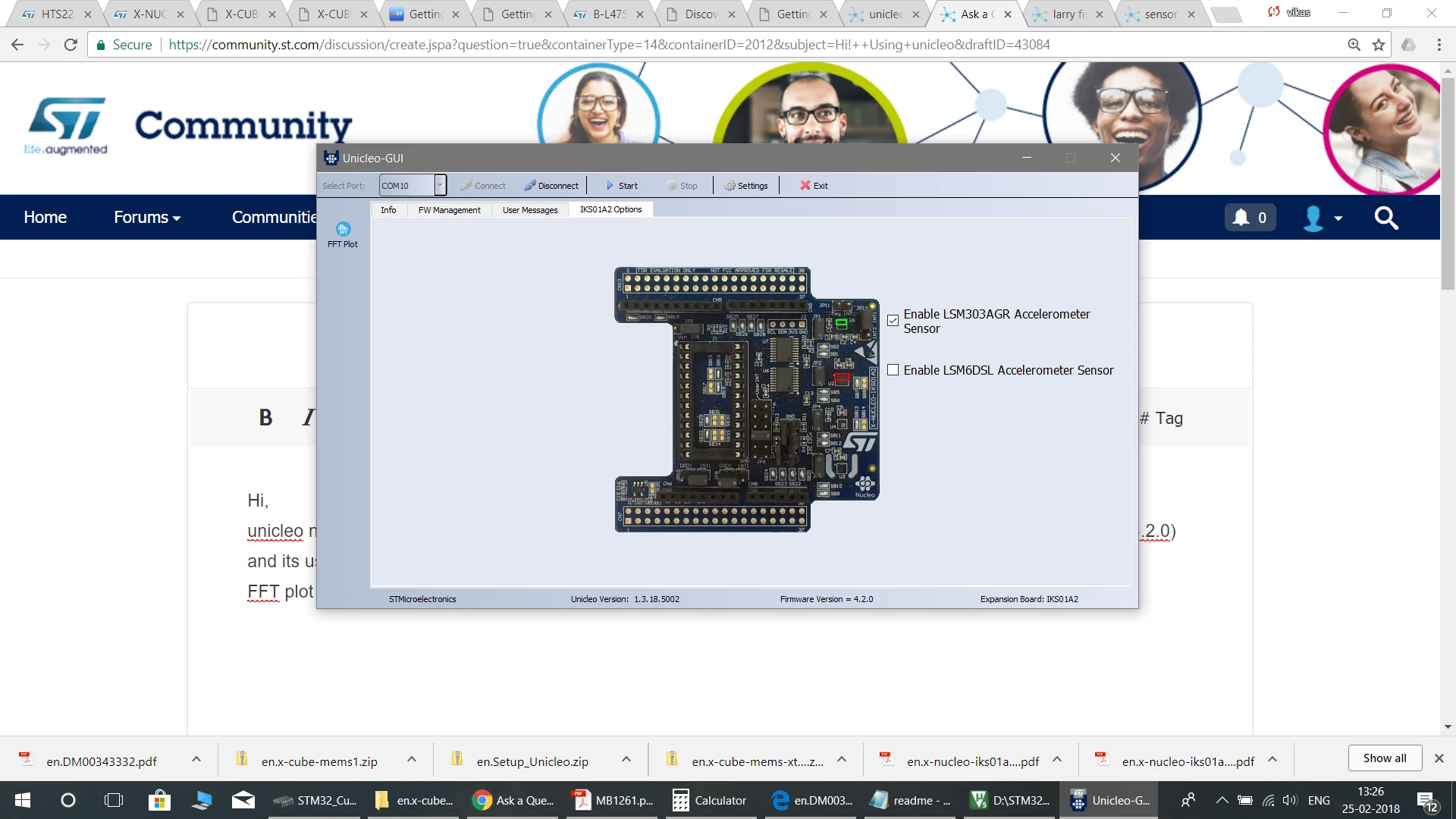

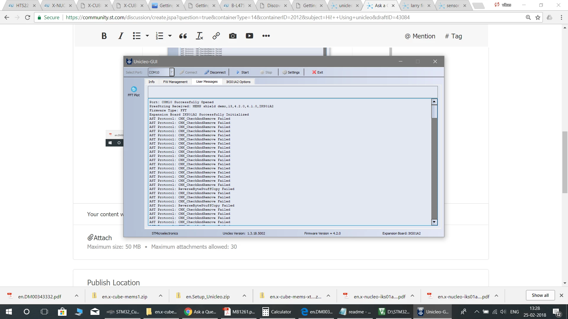

unicleo not working in FFT mode with (&sharpIKS01A2+ NUCLEO-F401RE with STM32CubeExpansion_MEMS-XT1_V4.2.0) and its user message window is showing ''AST Protocol: CHK_CheckAndRemove Failed''.
FFT plot is not showing any graph.
Please help !
Thanks in Advance !!

I see you have Keil uVision program opened, did you modify the FFT_demo example?
Can you please try to use already compiled binary located in binary directory?

I'm not able to replicate the issue.

Hi Miroslav,
your timely response helped us a lot !
I must say that you catch the right point and when I programmed it with binary, it worked
But now it is not working with Tera-Terminal software at baud rate 115200 bps; 8 data bits; No parity; 1 stop bit; no hard flow control given in the readme.
I will look into this and update you in the post.

Please try 921600 baud.

Hi Miroslav,
As per suggestion it is working in 921600 baud rate. Then i think it is wrongly mentioned in ReadMe for
115200 bps.
Thanks for your immediate reply !
Please give me one more support (if possible).... can you kindly suggest some documents which will help us to understand FFT library functions given in this file, so that they can be modified and reused in other applications.
