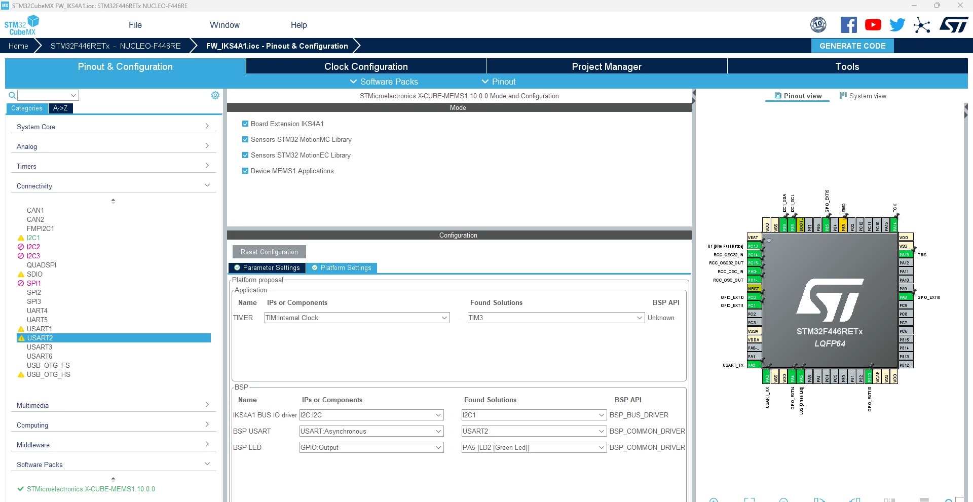

   I am trying to test the compass of the IKS4A1 board with a Nucleo F446 board.
I followed line by line the instructions provided in the "Getting started with the STMicroelectronics X-CUBE-MEMS1 software package for STM32CubeMX". My cube project locks like this:

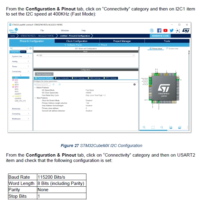

I would point out that in the IKS4A1 Getting Started guide it is said to set the UART speed at 115200 (page 53 and page 60) and the CubeMX when builds for the IKS4A1 sets the speed at 115200:

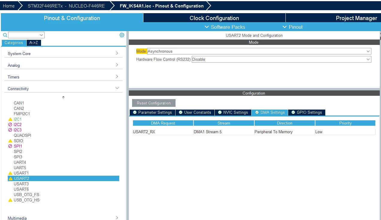

I enabled the CRC but if you don't set the DMA as below, you will get an hard fault:

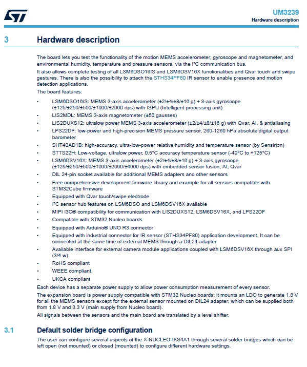

Now, I would like to test the e-compass application using the IKS4A1 LIS2MDL 3D magnetometer and LSM6DSO accelerometer but it seems the demo requires a further expansion board. The magnetometer, accelerometer etc should be integrated on the IKS4A1:
I will try to change the configuration maybe I will open another post.
