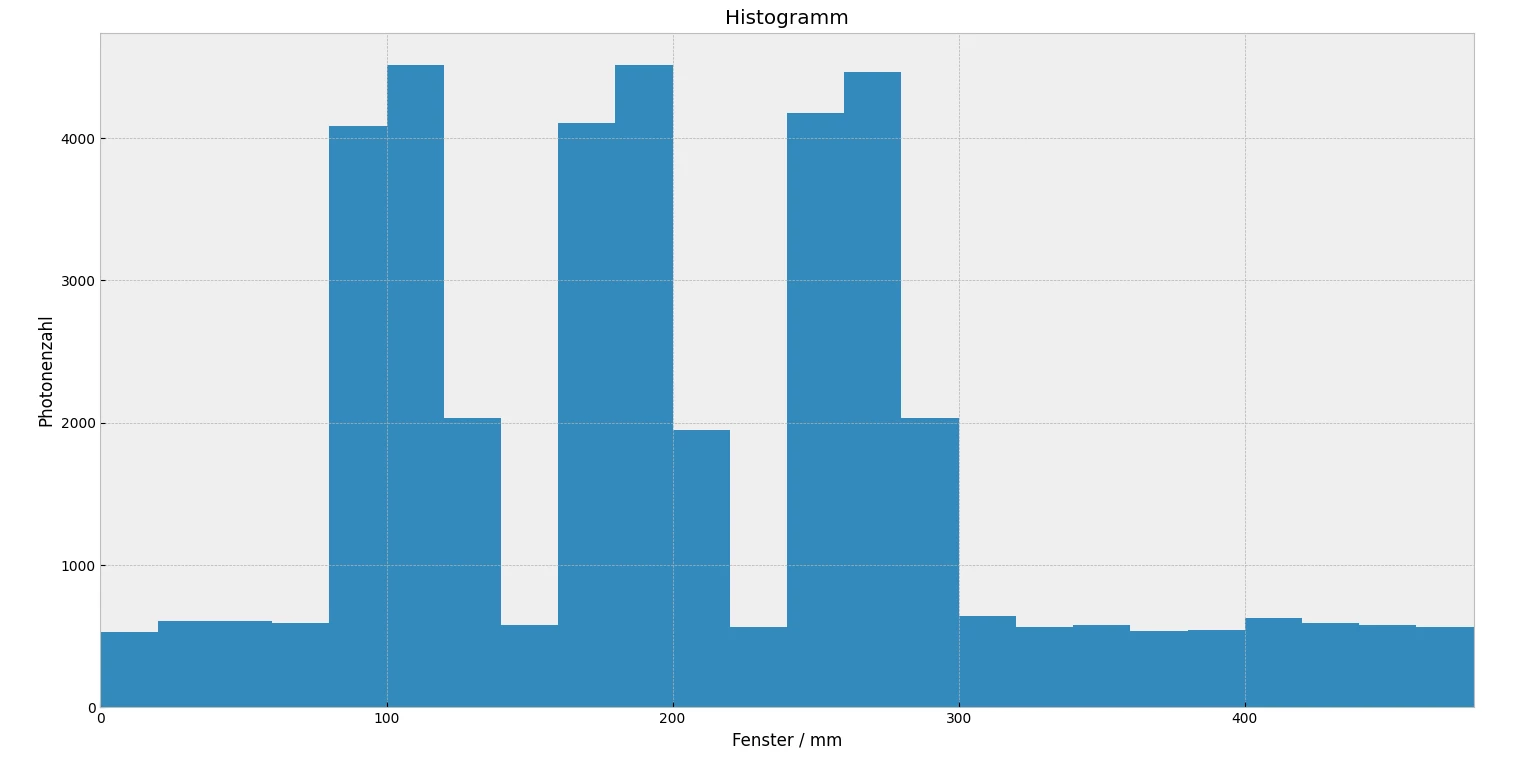

I've checked my histogram data generated by VL53L3CX Sensor and I also have those additinal spikes in my plot (see below), although there are no additonal objects within field of view. The Sensor is fixed in 70cm height and directed towards a white wall in 60cm distance. I assume the calibration data has not been included yet, since actual range report seem to be okay. Where do these two spikes come from?
John E KVAM
October 18, 2021
I think there is something wrong with your data capture. You are right. One object - like a wall will give you 3 'posts', like you have, but you will not those repeats.
Would you be willing to share some pseudo code?
Each bin is 20cm (more or less) So at 60cm you would expect to see data in the 3rd bin. And adjustments within the 20cm depends on the ratio between the first and second post. So I would have expected to see two bins at almost the same height as you have.
At 70 cm the initial post would be about half that of the second one.
That data almost looks like the combination of multiple collects. Very similar, but slightly different values - what I would expect from multiple collects.

Alright, I have defined the following array inside my result structure
int32_t histogram[VL53LX_HISTOGRAM_BUFFER_SIZE];
which holds bin data for each VL53LX_MultiRangingData_t
memcpy(result->histogram,
	VL53LXDevDataGet(pdev, LLData).hist_data.bin_data,
	sizeof(result->histogram));
Then I just format it into a string
HAL_StatusTypeDef TransmitHistogramDataRS232(
		UART_HandleTypeDef *huart,
		measurement_result *rdata)
	char bin[5];
	char buffer[150];
	sprintf(buffer, "%u;%u;", HISTOGRAM_DATA, rdata->sensor_id);
	int i = 0;
	while (i < VL53LX_HISTOGRAM_BUFFER_SIZE - 1)
		sprintf(bin, "%i-", (int) rdata->histogram[i]);
		strcat(buffer, bin);
		i++;
	sprintf(bin, "%i", (int) rdata->histogram[i]); // print last element without splitter
	strcat(buffer, ";\r\n");
	return HAL_UART_Transmit(huart,
			(uint8_t*) buffer,
			strlen(buffer),
			strlen(buffer) * 10);
On my computer a simple python script is running, which encodes this string to an array again and plots the data.
Edit: By the way, I also realised that two subsequent histograms always differ by a shift along the x-axis. Is that a correct behaviour?

FLiu.3
December 28, 2021
@ABesp.1​ Hello, have you sovled the 'repeated posts' problem?
@John E KVAM​ We also met the similar problem, when we faced towards a white wall in ~60cm distance, the data we collected are shown below.
Objects=1, Status=0, Distance=613mm
918 868 48957 65546 35408 1175 1143 964 916 940 48461 66164 36065 1159 1113 947 919 944 941 928 846 880
where the first row is achieved by `VL53LX_GetMultiRangingData` and the second row is by `VL53LX_GetAdditionalData`. Code is attahced as following.
status = VL53LX_GetMultiRangingData(Dev, pMultiRangingData);
status = VL53LX_GetAdditionalData(Dev, pAdditionalData);
pHistData = &(pAdditionalData->VL53LX_p_006);
if (pHistData->number_of_ambient_bins > 0) {
 if (status==0) {
 status = VL53LX_ClearInterruptAndStartMeasurement(Dev);
 continue;
// You mentioned that
// 'The first 2 'bins' of the arrays are NOT histogram data.'
// 'And the next 4 bins of the 'a' array are ambient data - not histogram data.'
for(int i = pHistData->number_of_ambient_bins+2; // start from truly histogram data
 i < VL53LX_HISTOGRAM_BUFFER_SIZE; i++) {
 printf("%5d ", pHistData->bin_data[i]);
no_of_object_found=pMultiRangingData->NumberOfObjectsFound;
printf("\n#Objects=%u, ", no_of_object_found);
for(j=0; j<no_of_object_found; j++){
 if(j!=0)printf("\n");
 printf("Status=%u, Distance=%hdmm",
 pMultiRangingData->RangeData[j].RangeStatus,
 pMultiRangingData->RangeData[j].RangeMilliMeter
We have noticed two problems from these collected data.
  1. One additional cluster of spikes appeared although there are no additonal objects within field of view (i.e. the repeated posts problem). You mentioned that it looks like combination of multiple collects, how can we solve it?
  2. There are obvious offset for all histogram data, are they come from ambient light? how can i remove them? (one possible solution maybe directly subtract all the values by the estimated ambient value in `VL53LX_histogram_bin_data_t`, i.e. `VL53LX_p_028`)
