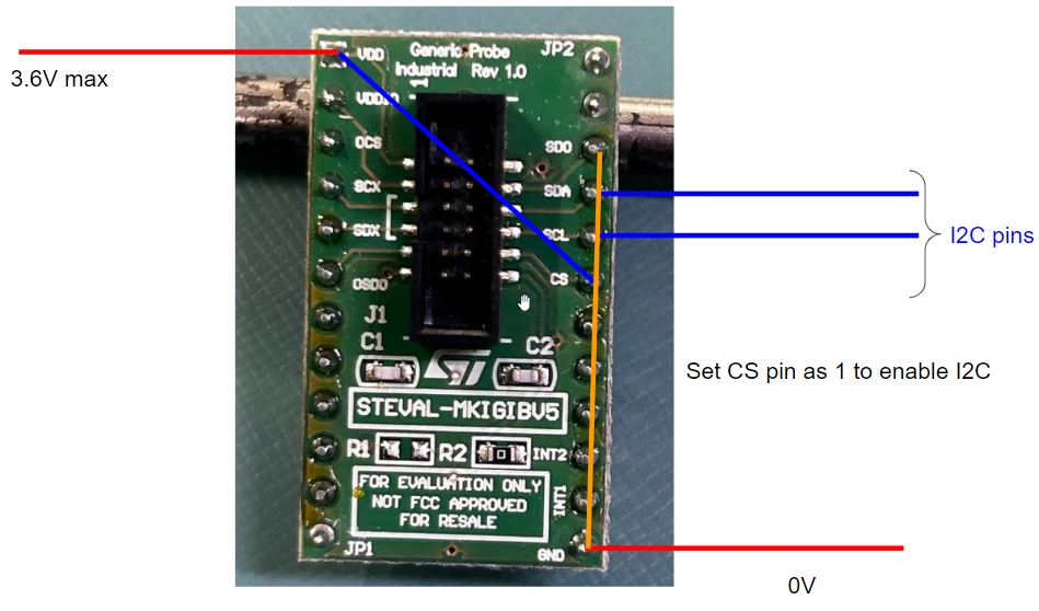

I am trying to get a ISM330IS IMU working. I have ordered a development kit from Mouser / ST Micro with the following board number https://www.mouser.in/ProductDetail/STMicroelectronics/STEVAL-MKI230KA?qs=amGC7iS6iy%252B%252BWAEBNHSnWw%3D%3D (photos are also attached).

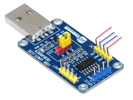

I have done the wiring referring to the User Manual Section 5.1. (photo is also attached). I am using a I2C to USB converter (photo is attached below) to read the data in a linux based Ubuntu 22.04 PC via library i2c-dev.
Link to User Manual I am following: https://www.st.com/resource/en/datasheet/ism330is.pdf
I am able to connect to the I2C bus and connect to Slave Address as per User Manual Section 5.1.1.1.
I am facing a problem:
  1. When I am trying to read the IMU data through any register (for Temperature sensor or WHO_AM_I from user manual page 30), all the values are coming out to be zero constantly. I am unsure what the reason for this is. (I am not getting any kind of runtime errors).
Does someone have an idea why this could happen? Perhaps I am missing something to start the communication via I2C. Or something needs to be triggered before I start reading these registers on the sensor hub?

Federica Bossi
November 3, 2023
Hi @sa32953 ,
Welcome to ST Community!
From your photos it seems that you are connecting GND of the STEVAL to SCL of your board. Can you check this?
