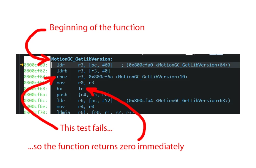

Unable to initialize X-CUBE-MEMS1 libraries
I'm using a NUCLEO-L476RG with a STEVAL-MKI197V1, connected in SPI mode without any expansion board. My setup works: I successfully used the LSM6DSOX low-level driver to read sensor data.
But my attempts to use the high level libraries, such as MotionAC and MotionGC, have failed:
  • MotionAC_Initialize() and MotionGC_Initialize() always hang with a hard fault interrupt, and
  • MotionAC_GetLibVersion() and MotionGC_GetLibVersion() always return zero.
I think I've followed the setup instructions, including adding the CRC module, but obviously there's something I'm doing wrong. Any idea?

October 11, 2021
Unfortunately I don't the sensor at hand but If I debug the generated project from your .ioc file on NUCLEO-L476RG board I able to pass the MotionGC_Initialize() function and the GetLibVersion() function returns correctly the library version.
The only change I did was that I uncheck "Generate Under Root" but I don't think this the root cause.
Would you please try it again and maybe increase the stack size.

paul19Author
October 11, 2021
@Miroslav BATEK​ , thanks a lot for looking into this.
I doubled the stack size with no success.
I noticed the MotionGC_GetLibVersion() function fails at its very beginning, after a single test. See here:
0693W00000FC5UUQA1.pngIf you have access to the library source code, this might give a clue.
paul19
paul19Author
October 11, 2021
@Miroslav BATEK, I found my error regarding MotionGC_GetLibVersion(). I was calling it *before* the lib initialization, and it seems it's wrong, despite what's described in UM2181 chapter 2.2.3 diagram. So now MotionGC_GetLibVersion() works.
