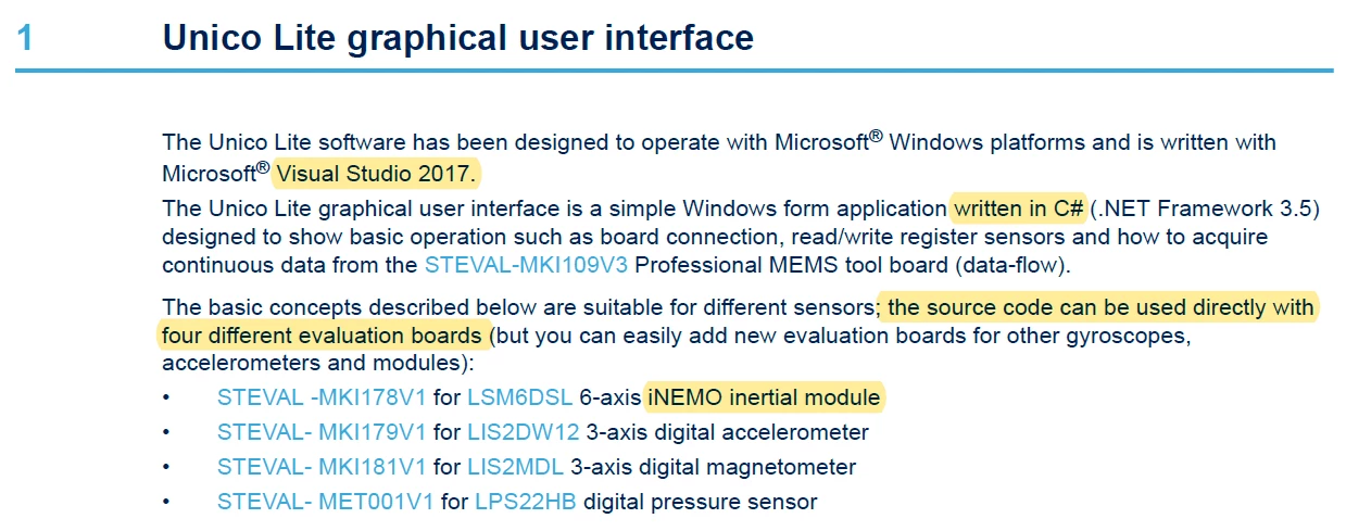

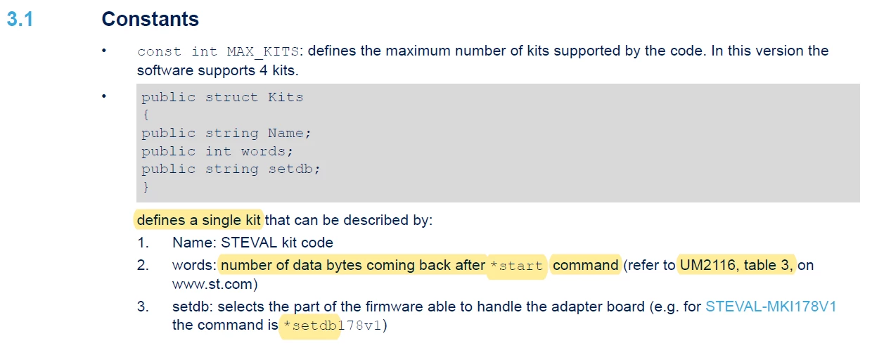

I am using MKI109V3 with Unico Lite and MKI239A. Following UM1064, I need to edit the source code to add MKI239 as additional evaluation board for a combo of acclerometer and gyroscope.
The UM1064, user manual of Unico Lite, suggests to find “number of data bytes coming after *start” and "setdb" from UM2116. But the relevant information for MKI239A is not included in UM2116/Table 4 "Returned values for *start command".
May I kindly ask if this information could be provided? Thanks a lot! I am trying to make everything work before Christmas.
P.S. Below are two screenshot from UM1064 (Section 1 and Section 3.1), showing it is supposed to be straightforward to add new evaluation boards, as long as info is provided in UM2116 table 4...

May I further ask how I should determine the "number of data bytes" for your provided returned values? Should I consider each element (e.g. ACC_XH) as 1 byte and simply add them up?
Also for the "*setdb" for MKI239A, should it be *setdb239, or *setdb239a, or perhaps *setdb239aV1?

You can try *setdb239a.
Yes, each element is 1 byte and you can add them up considering s as byte 0.

Thanks! *setdb239a works!
