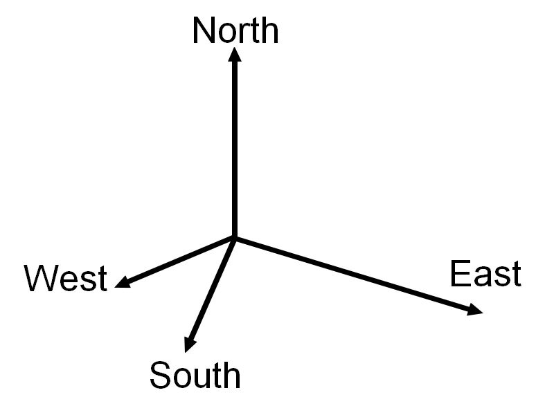

When angle = 0° : X² + Y² = 2² + 35² = 1229 (X is the average of 5 X values and the same for Y) Then I rotate my mems of 90°, the angle displayed by my device is around 70° : X² + Y² = 300² + 103² = 100609. I guess the value should always be the same because I am just rotating the magnetometer.
Moreover the result is wrong because East (0°) is not "aligned" with West (180°) . What I means is that when my algorithm says 180° I have rotate my mems from lots less or lots more. In fact there is not an angle of 90° between any "axes" (N, S, E or W).
My real problem is that my angle is not moving "linearly". For example, in the image below, between North and East, with atan2 I get 270° which is obviously wrong regarding to the direction.
I added the image of what I see.
diagram starts with East : angle = 0°. South is draw when angle = 90°.

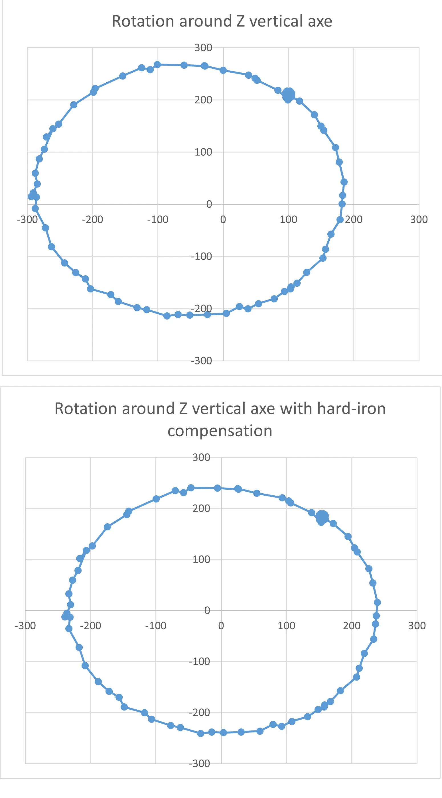

Hi @Eleon BORLINI​ ,
Thank your for pointing out the hard-iron effect ! This was my mistake !
I looked at the (X, Y) graph and indeed the center of the circle was not, well, centered.
I now understand that I need to use a calibration step like phones do. Indeed, you need to rotate your device to get current center position and then use an offset to center you magnetometer values. (this offset is the average of max and min value)
Pictures I link show the before and after hard-iron effect.
To all people finding this post, I suggest your to read this blog which is quite clear on how to compensate the hard-iron and soft-iron effect : https://www.fierceelectronics.com/components/compensating-for-tilt-hard-iron-and-soft-iron-effects
( Sorry but the design tips link you give @Eleon BORLINI​  with Matlab algorithm is too complex / not easily physically understandable when you try to figure out "why")
Hope this post will help others.
Simon

Eleon BORLINI
Oct 28, 2020 11:10 AM UTC
Hi @SimonF​ ,
thank you for you feedback and your solution report.
You are right, the "figure of 8" shown by smartphone apps is for the magnetometer calibration.
-Eleon
