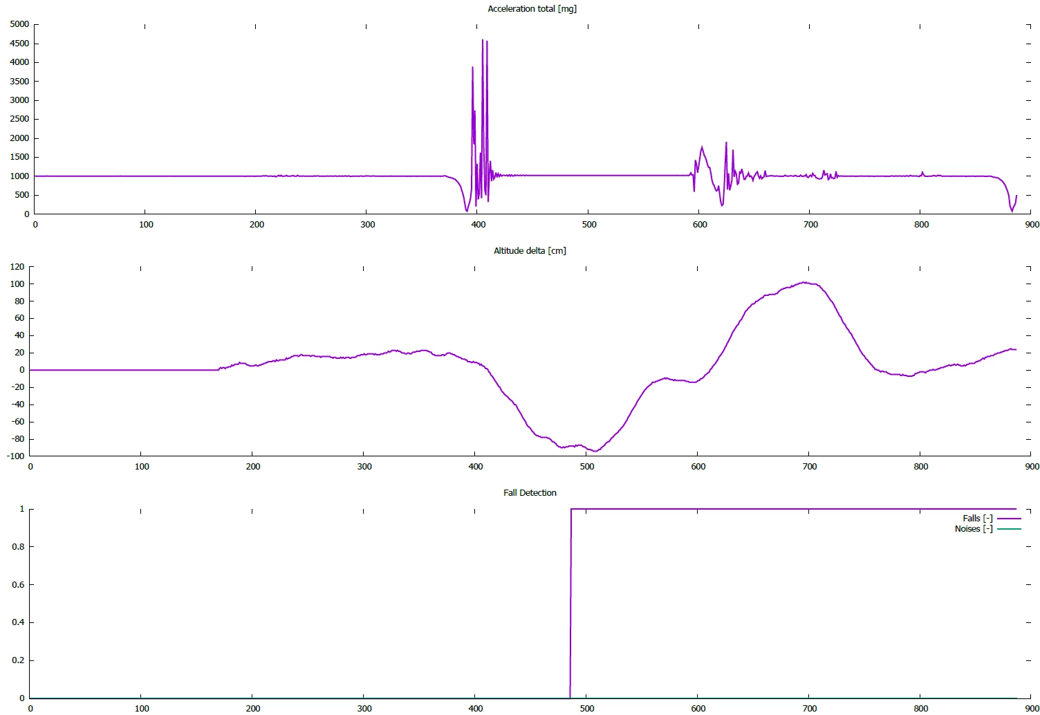

Well, I switched HW to the board that the falldetection app was designed for (x-nucleo-iks01$2).  Everything built and downloaded and runs.  The unicleo gui connects happily.  I can see lots of user messages streaming by - pressure, temp, hum, accel, gyro, magnetometer.  My question is: How do I make it detect a fall?  I have tried dropping it 2-4 feet, onto my lap, in a towel, etc.  I never see the app detect a fall.  Any guidance on this lib would be helpful...
Thx - Larry
October 10, 2017
Posted on October 10, 2017 at 09:32
Indeed, to simulate the fall can by quite tricky.
I will explain a method which work for us:
- Wrap the board into some foam to avoid a damage when the board hit the ground
- Hold the board in vertical position (USB connector down)
- Drop the board
- Let the board still on the ground for a while
To evaluate the impact as man fall the altitude must change about ~80cm, the impact should be higher than 3-4g and the board must remain still after the impact.
Here is one example of fall detection:
