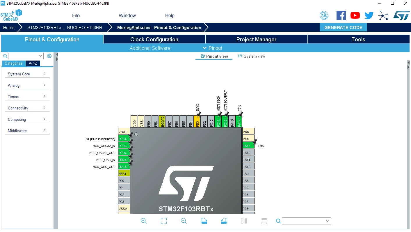

    Attila_S
    Visitor II
    November 28, 2019
    Of course,
    I use CubeMX to configurate the pins as u can see in the first picture.0690X00000AsbMWQAZ.png
    And here is my code:

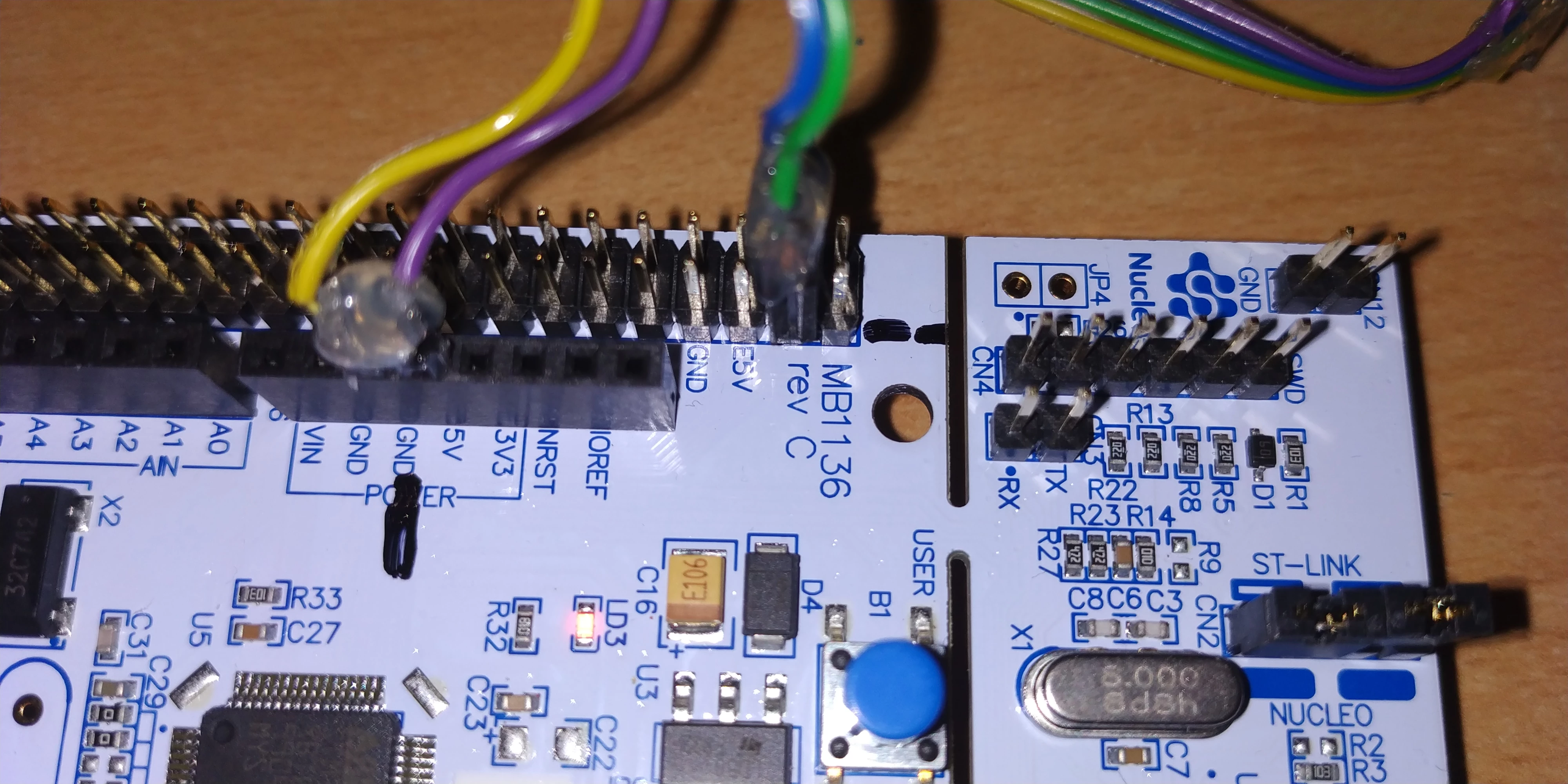

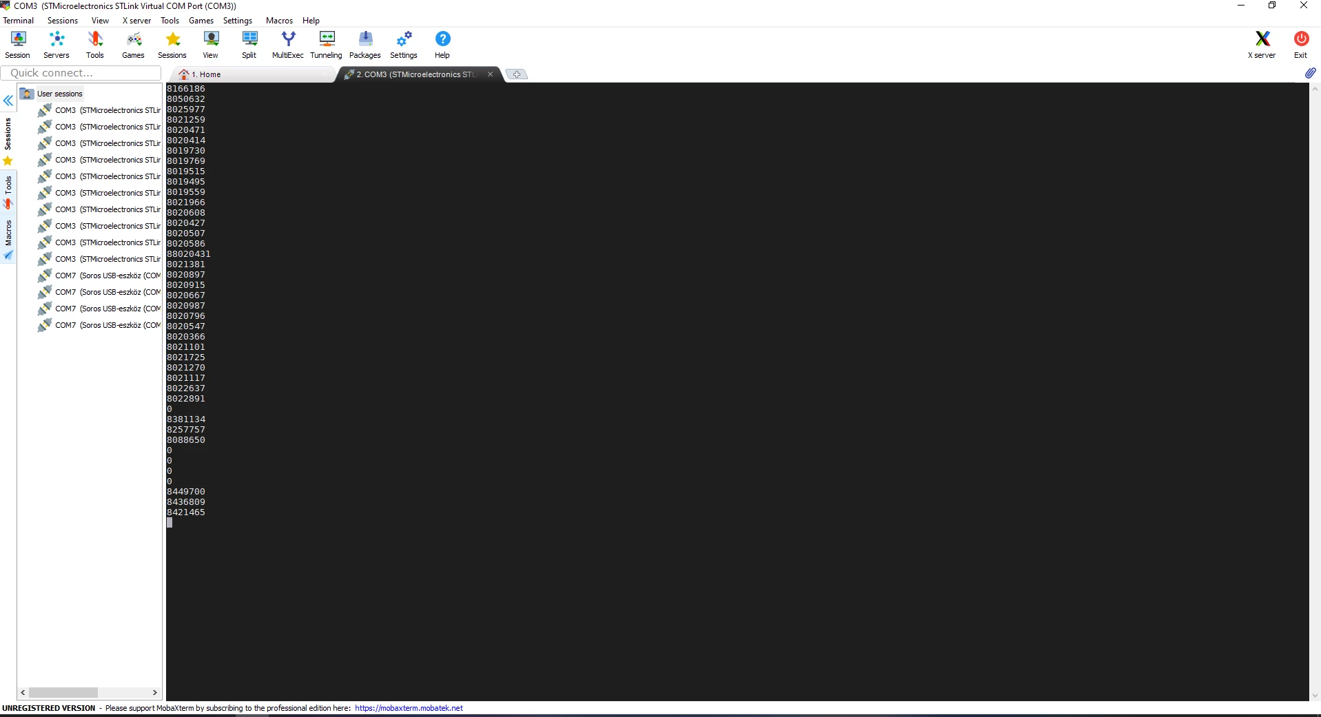

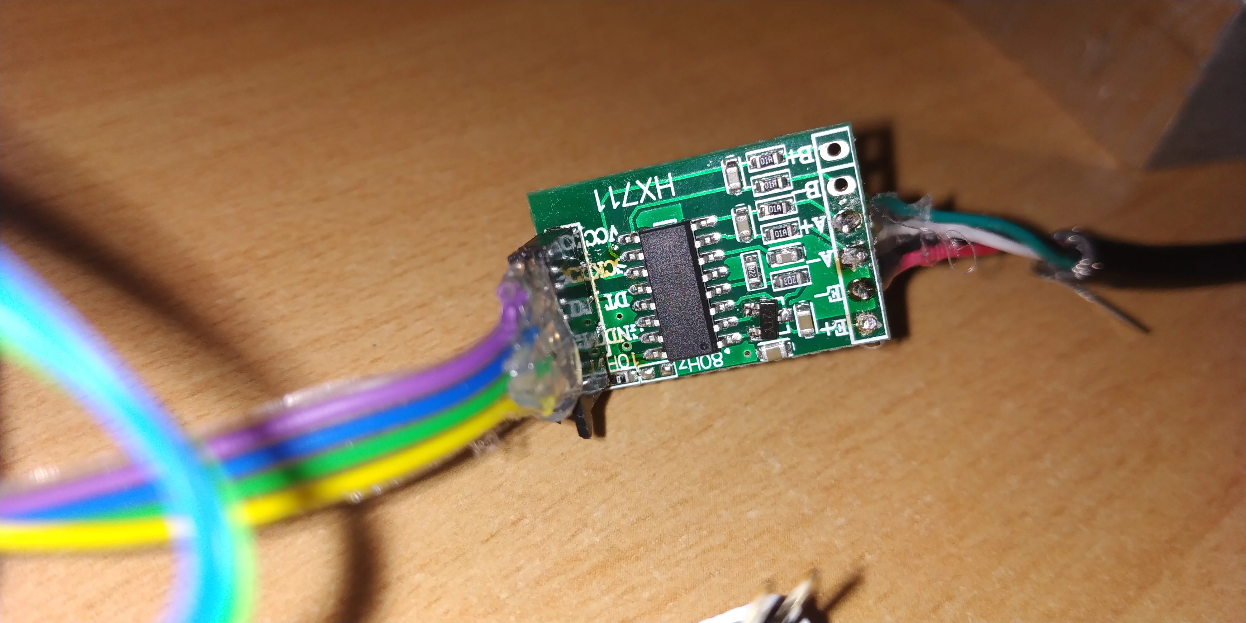

    So now I'am finally getting back something else than 8388608 but they are still random numbers for some reason.
    Here is my setup:
