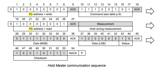

I'm trying to get the sensor value with stm32
Maybe because I connected the board to one i2c and attached two sensors, the value didn't change
Most people use cereal, but I only use C, so I have to use HAL
The sensor that allows you to read only one is HTU21
I'm doing this and that, but I only got 01 00 00 00 00
I think I didn't code properly, but I don't know where to fix it
I want to get the sensor value and use it as a hex value and float value, so please tell me how

Hello @ark​,
I suggest you try to use the I2C sensor address without shift:
HAL_I2C_Mem_Read_IT(&hi2c1, (uint16_t) hum_addr , hum_sec_addr, 1, R_buffer2, 5);
Hope my answer helped you!

0xE5 doesn't seem like it can be a valid address.
Foued_KH
November 1, 2022
It's a measurement command (Temperature) for the read.

Take an oscilloscope (not a logic analyser guys) and observe the i2c bus. Monitor the slave address ack bit.

The code doesn't appear to provide the 7 to 50 msec Hold during measurement. See page 5 of the data sheet.
(Edit) You might try asking for example code as stated on data sheet page 10. The data sheet date is 9 years ago, so there may be no response.
