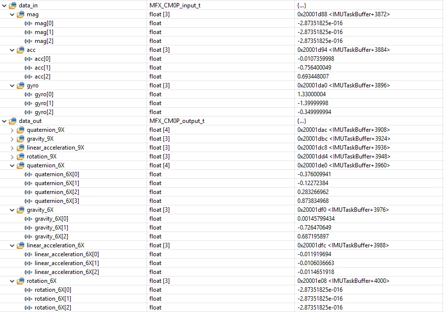

Three qestions about MotionFX CM0+
Hello wonderfull STM community,
Really enjoying the experience with MotionFX so far, really easy to implement and get working, well done ST! Even on a G0 in CM0+ mode its working well! I'm just woudring three things:
  1. What precaution(s), if any, should be taken when pausing and later resuming the RTOS task that runs MotionFX_CM0P_update()?
  2. What is the refrence point for the quatenion in 6x mode? (to be fair I have not worked much with quatenions before so that might be an uneducated question. They are quite complex after all! (pun intended))
  3. Is it normal for data_out.rotation_6x to be near 0 (e-16) during oppration in 6 axis mode? (other values, inlcuding inputs, are changing as expected)
Note that mag is just uninitialized, the values are those of what was already in memory, I should fix that, through this is the first I've noticed it.

Hi @Pantera_MXJ ,
I share also here the corrected code you posted on the other topic, so that if someone else in the future encounters the same issue can solve:

Hello WrenchInTheWorks
Have you manage to get fusion values that are correct using the MotionFX library? like heading, Roll, Pitch, Yaw?
If yes how did you define this part:?
strcpy((char *)MotionFX_knobs.acc_orientation, "swu");
strcpy((char *)MotionFX_knobs.gyro_orientation, "swu");
strcpy((char *)MotionFX_knobs.mag_orientation, "enu");
and what sensor/board you are using?
Kind regards
JD

Hello @Pantera_MXJ,
I'm getting values for everything but Roll, Pitch, Yaw, unsure why, maybe because I have not set my orientation yet or because you may not get them in 6x mode, not sure . I've got bigger problems in my code base to deal with now that I know I can get values in out of the FX engine.
So to answer your first question I ignored that part (for now), I'll let you know once I get that sorted.
I'm using a custom board with the LSM6DSMTR.
Thanks for the help! I have a IKS02A1 I had some progress but still some values are not ok, I think I'm close but something is wrong, I just added the code in the post I have related to this problem:
X-NUCLEO-IKS02A1 sensor orientation (axis) on PCB ... - STMicroelectronics Community
Kind regards.
