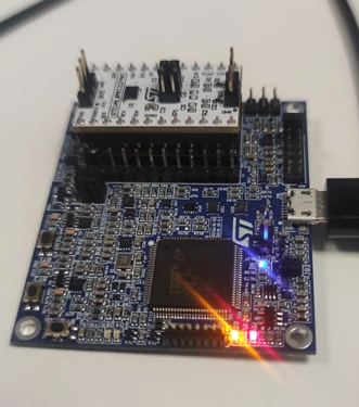

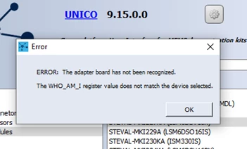

I tested out the QVar using Unico GUI with the MKI227KA kit and the motherboard MKI109V3. It worked until I tested out afterwards the Sensortile box PRO using algobuilder and Unicleo GUI. Since then when I tried using back Unico GUI it shows me an error message :
What I tried to fix it:
-I uploaded the firmware (ProfiMEMSToolV3.53.3_00_08000000.bin) back into the MKI109V3 motherboard using Cubeprogrammer.
-I tried switching the MKI109V3 motherboard with a brand-new one with the exact same reference and the same message still appears after initialization.
I am unsure why I'm getting this error message. Any help would be much appreciated.
