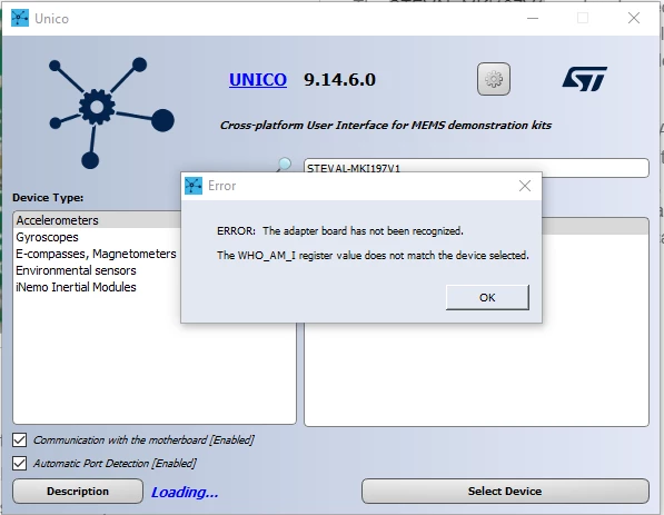

The WHO_AM_I register value does not match the device selected
I am using a STEVAL-MKI109V3 mother board to evaluate 2 accelerometers :
  • LSM6DSOX (STEVAL-MKI197V1)
  • LIS2DUXS12
I want to use the GUI software UNICO v9.14.6.0 but when I want to connect my device, an error popup appear : "ERROR : The adapter board has not been recognized. The WHO_AM_I register value does not match the device selected".
I have updated the motherboard firmware with the v3.48.3 but I still have the problem with my 2 MEMS boards ...
Can someone help me ?

    TZapp.1
    TZapp.1Author
    June 7, 2023
    Hi @Federica Bossi​ ,
    Thank's for helping me.
    Here is the steps I followed :
    • Connect my MEMS board (STEVAL-MKI197V1) on the STEVAL-MKI109V3
    • Plug it in my computer
    • Launch UNICO v9.14.6.0 software and select "STEVAL-MKI197V1" in the Device Name table
    • Click on Select Device and here is the error popup
    • Click on OK and here is the main window but I still can't connect ..
    • Tried to click on connect but same error popup appear
    • Tried to go back and select a second time the device name put same error pop-up
    • I tried with another MEMS board which is a bit different but it is the same scenario
    • I tried with another USB cable but still don't work
    I hope my explanations are clear.
    Thank's in advance for your help.

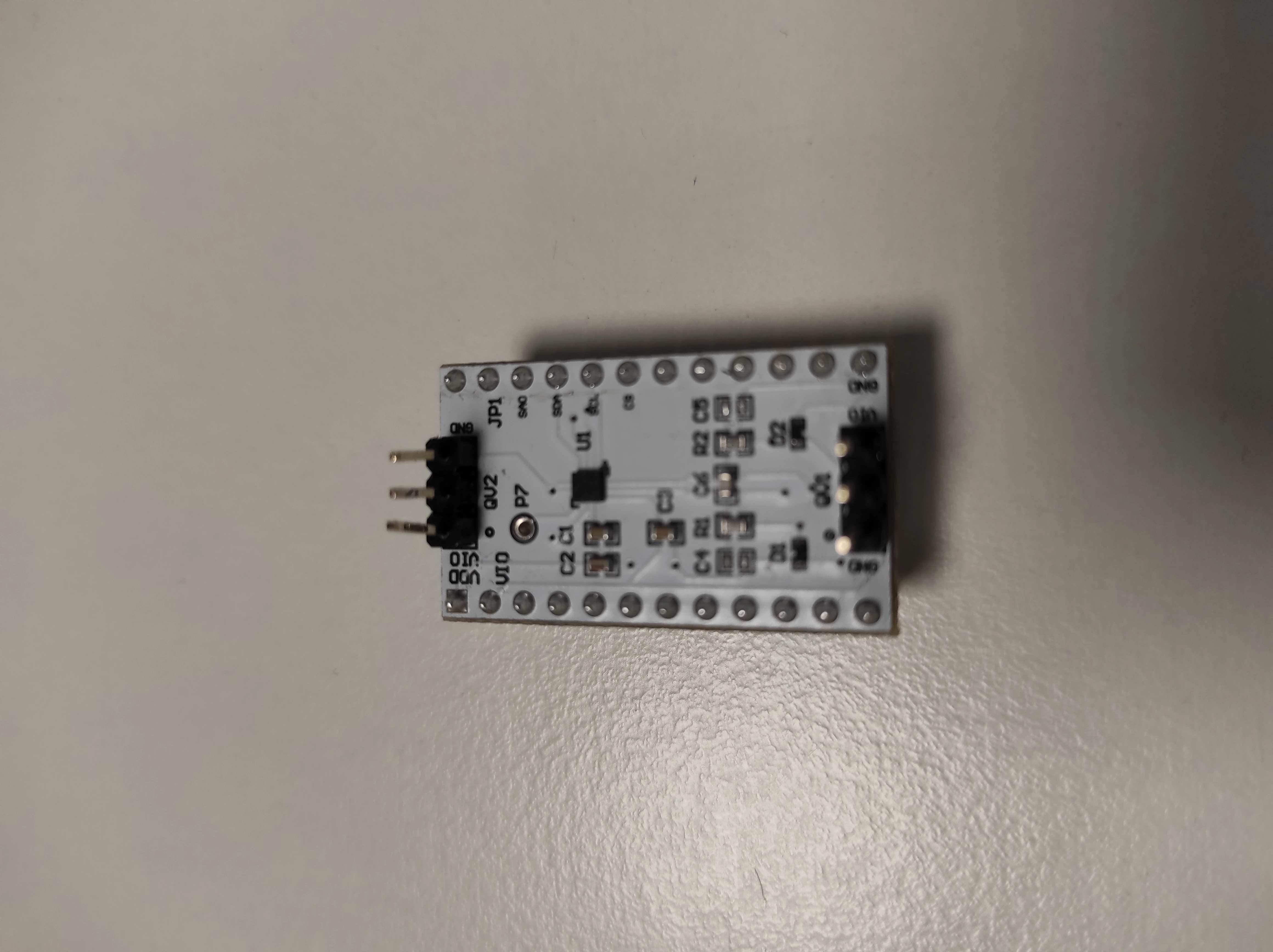

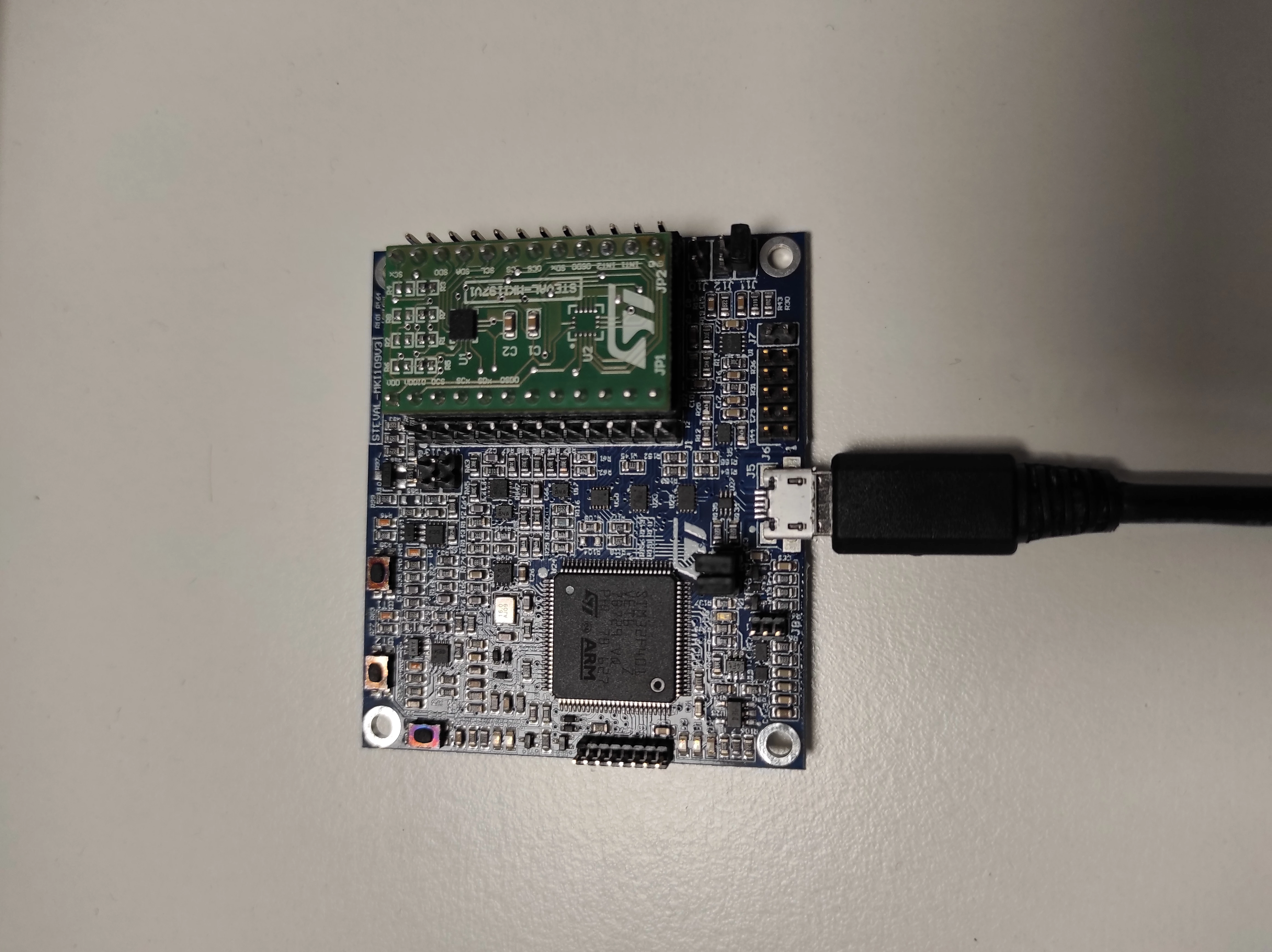

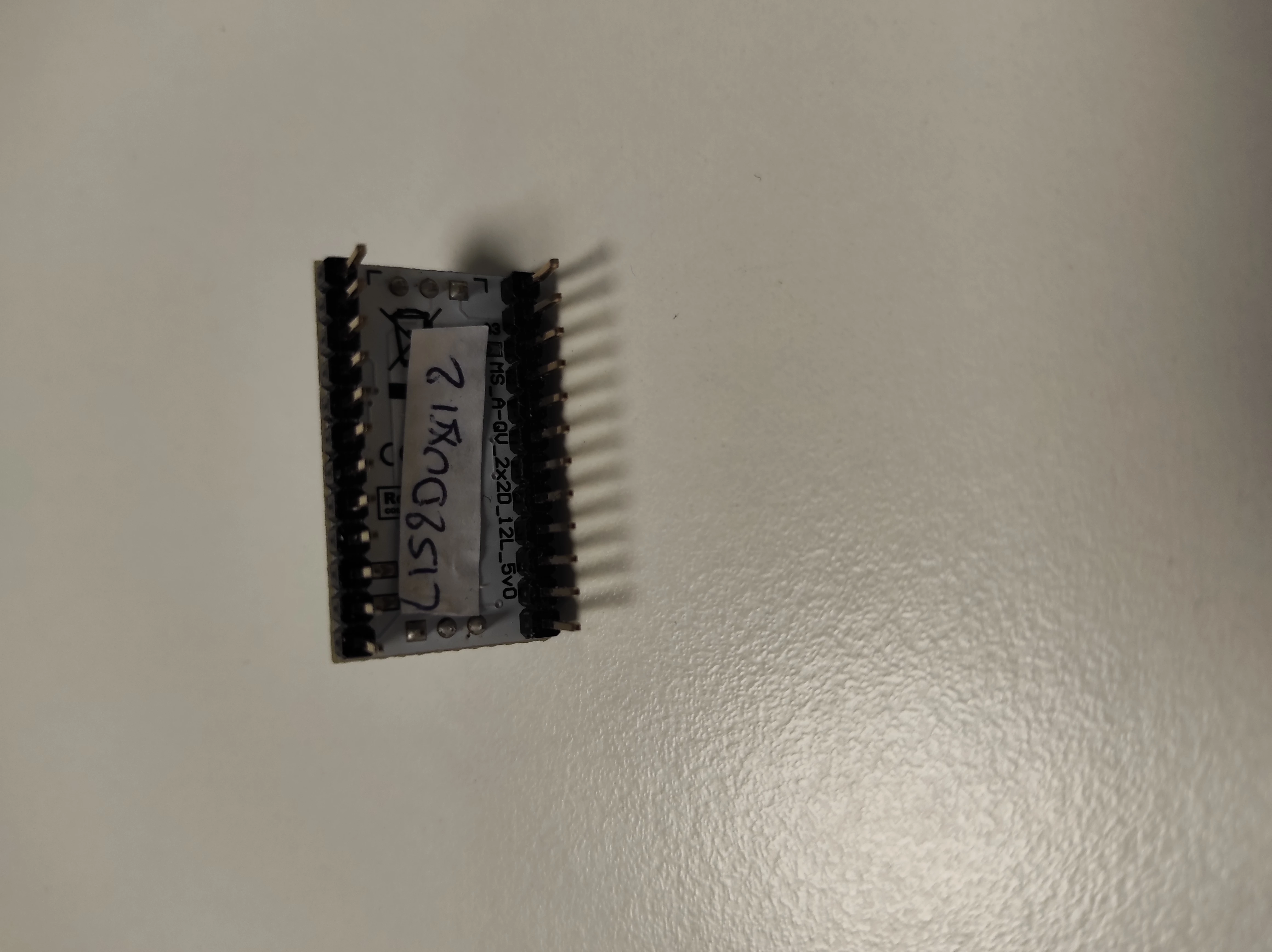

    FKara.3
    September 27, 2023
    Hello @Federica Bossi ,
    Please see attached photo.
    Thanks,
