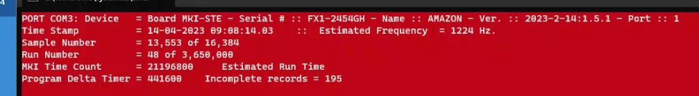

    _legacyfs_online_stmicro_images_0693W00000bi6z2QAA.pngI am running the devices at 1666 Hz as the theoretical setting. There are a number of issues that going forward that I would like to work out how to solve.
    The first issue is the lack of a serial number on the device. STEVAL-MKI109V3 is there a reason that these do not have a serial number. They are plugged into USB ports and so the COM number can change and so if we have two on one computer, making sure the reboot has the correct com number to feed the data into the correct database going forward will become important. David Reynoldson of ST from TEXAS said we may have to get a 109 board manufactured if we want a lot. Can we add a serial number here?
    The second issue is that I have the ten accelerometers running on about 8 NUCS. They are all as identical as I can make them, same parts, same windows and they are in the same location on the same network for 7 and 1 on another network. The picture shows them running at 1224 Hz for this one, they run in the range of 1200 to 1450 Hz for the 1666 setting. I am measuring the running every 8 seconds and once they settle down - usually a minute they are stable just not at 1666. The issue is the different frequencies mean that the FFT has different steps. We want to use this to measure structures so a constant FFT step size would be nice. I can live with this, but UNICO-GUI does not tell you what frequency you are running at in reality as it does not return the timing function.
