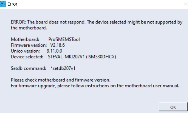

The problem of connecting the STEVAL-MKI209V3 with ISM330DHCX to the computer.
Hello! I need help.
I'm using windows 10. To work, I downloaded the latest version of Unico-GUI.
The following error occurs.
0693W00000JNx49QAD.pngMaybe I need to install drivers for the ISM330DHCX module ?

    Hi @ABeze.1​ , probably you didn't updated the firmware (I see it is V2.18.6, probably the default one). You have to program the board with the .bin file you find in the package folder \FIRMWARE\ProfiMEMSTool board (at lease version V3.2x.xx)
    Here there is a guide on how to do it --> https://community.st.com/s/question/0D53W0000057tYrSAI/using-lsm6dso-on-stevalmki109v3-with-unico-gui-9710

    Thank you very much for your help!
    I updated the firmware and the module successfully connected.
    Best regards
