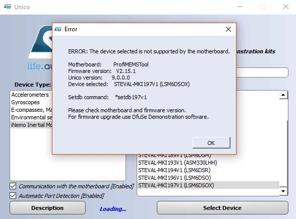

    0690X00000983m1QAA.pngHi, i in the end ordered STEVAL-MKI109V3 . i am able to run the unico tool with it using STEVAL-MKI185V1 (magnetometer daughter board) and it works nice. but when i attach the LSM6DSOX breakout board (STEVAL-MKI197V1), i am not able to read it. i get this error shown in the picture.

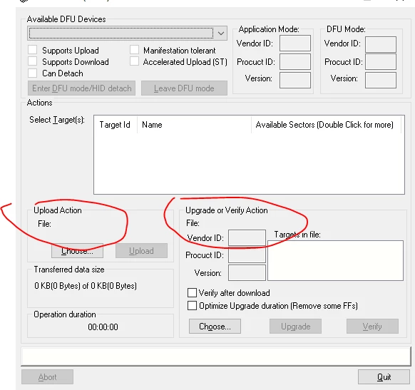

    was able to solve my problem. the STEVAL-MKI109V3 firmware was outdated. earlier i tried to update its firmware but the GUI of the DFU tool didnt have a good UX (as highlighted in the image). so instead of updating the firmware i overwrote the firmware file with the old firmware image from the STEVAL-MKI109V3. as a result everytime i tried to update the image properly it would write back the old image. 0690X000009841BQAQ.png
