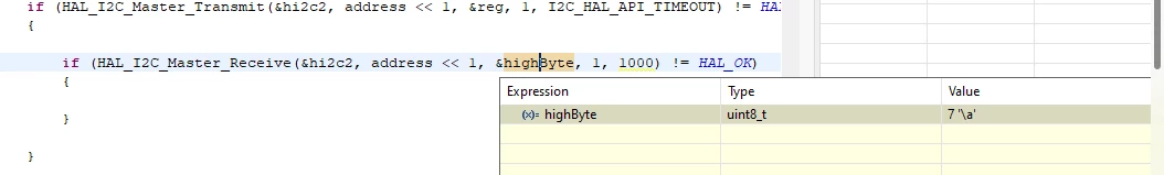

Hello All,
Need to read the values from the embedded Temperature Sensor in LIS3DH via I2C communication
I had made the following configurations as mentioned in the datasheet,
1. CTRL_REG4(0x23) = 0X80
2. TEMP_CFG_REF (1Fh) = 0XC0
3. Trying read the temperature value from the following register OUT_ADC_3_L(0x0C) and OUT_ADC_3_H(0x0D).
     - Getting the value from the OUT_ADC_3_H(0x0D) as 8. If I expose heat near to the chip the value is increasing.
How to convert this(8) value to temperature?
Kindly assist me to get the conversation formula. Here the Vdd supply = 3.3V.
Thanks in Advance.
Regards,
Surya S

As reported in Table 5 of the datasheet, the temperature sensor output change vs temperature: 1 digit/degree of Celsius.

Here the thing is the unit we kept the unit under room temperature 25°C and the value read from the register OUT_ADC_3_H(0x0D) is 7. How can equate this  8 to 25°C? Attached image is for your reference.
Thanks In Advance.

You should be able to read both the low and high byte in a singular 2 byte read operation. What's that number pair?
Post code section using the ... </> tool in the post edit window, not as a bitmap
