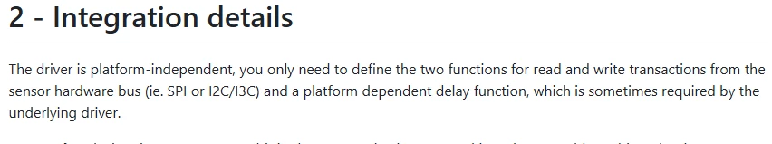

Remember that the LIS2DW12 neither knows nor cares what controller you use - its behaviour does not change for different controllers.
All the LIS2DW12 sees is the I2C or SPI bus - so it’s just a matter of getting the right interactions on the bus.
This is modelled in the C-Driver-MEMS software:

In addition to the documentation mentioned above, you can refer to the lis2dw12_wake_up.c example in the ST standard C drivers. It shows how to configure wake-up detection and route the event to INT1.
Please note that the example checks the event flags by polling the sensor registers; the ESP32-C6 GPIO interrupt handling must be implemented separately. The platform-specific communication and delay functions also need to be adapted.
The lis2dw12_reg.c/.h driver provides functions to configure interrupt polarity, push-pull/open-drain operation, latched/pulsed notification and event routing.
