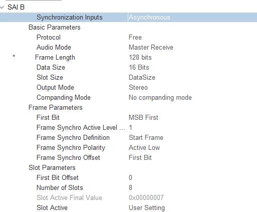

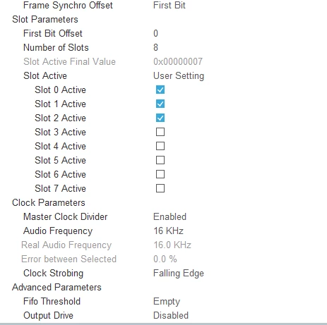

I try to use a custom board with LIS25BA.
I use SAI with STMF446.
What I know :
MCLK = 12.288 MHz
WCLK = 16kHz
8 slot with 3 active
so BCLK = WCLK * (8 * 16) = 2.048 MHz
What I can do :
I2C works like a charm ;)
What I can't do :
Configure SAI with these values.
Only MCLK is false and depends on Master Clock Divider I guess ...
My actual config :
If someone can help me, it would be so great
Thanks in advance

    Read out and check SAI registers, or maybe even better, don't use Cube just program the SAI registers directly.
    Make sure you have set a valid clock for SAI in RCC.
