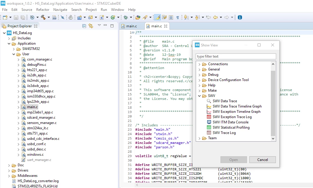

adding more topics for community support.
I find the SWV comsol in Window - Short wiew - other - SWV, and then select for example the SWV Data Trace.
For a tutorial on how to set up the proper variables to be monitored, you can refer to this video.

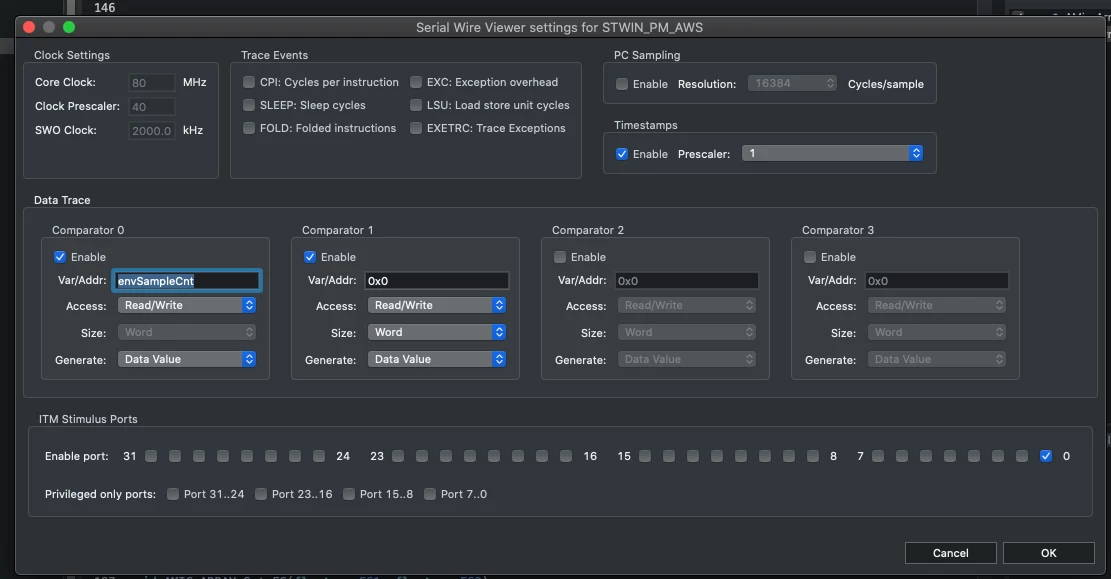

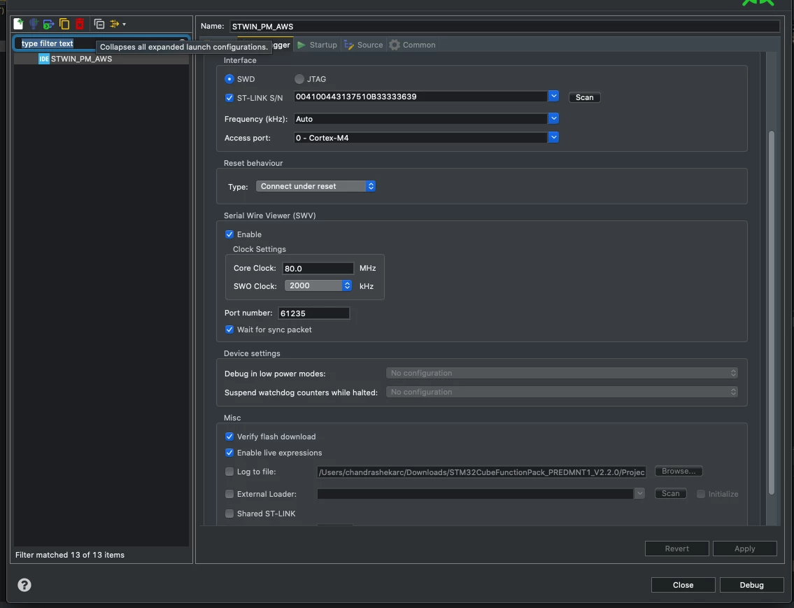

I am trying use SVW console for STWIN_PM_AWS application, instead of terminal, I wan to re-direct all the messages to SVW console.
Here is my debugger configuration
I did changed the puts function as following
