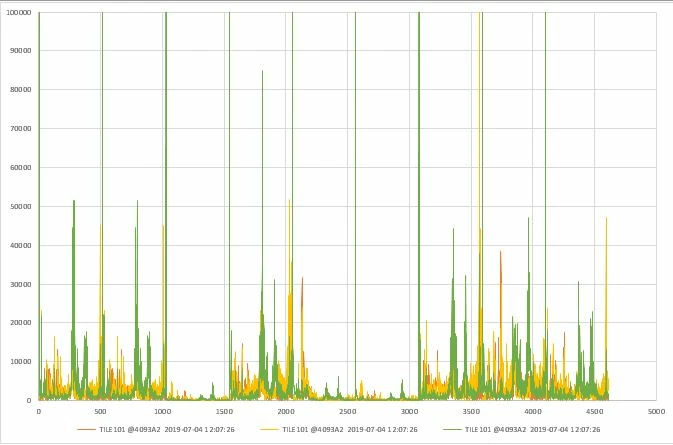

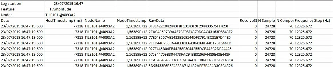

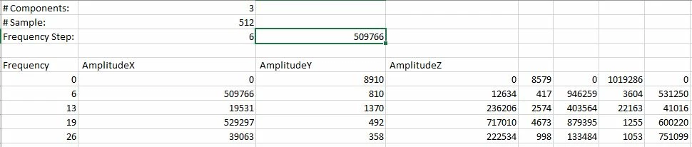

    Other pb, do you have a design tip for the FFT library to understand how the data is returned in the csv file. I do not see what the columns are
