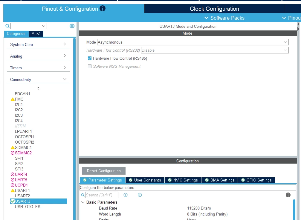

Hi all,
i am just trying to figure out how to connect the Stwinbox board with Rs485.
if you have any advice in terms of applications i must use and the recommended firmware?
regards
SimonePradolini
SimonePradoliniBest answer
Jul 8, 2026 11:47 AM UTC
Hello ​@Yaser57
Unfortunately, there’s no ready-to-use firmware example for STWIN.box.
But you can refer to STM32CubeU5 UART Example. With minimal changes, you should get a fully working application.
For example: let’s take one of the examples available here https://github.com/STMicroelectronics/STM32CubeU5/tree/main/Projects/NUCLEO-U575ZI-Q/Examples/UART. Most official UART examples use standard UART mode by default. To use RS485, you would:
  • Take an existing UART example from your target board
  • Replace the initialization call with HAL_RS485Ex_Init()
  • Configure the Driver Enable (DE) polarity and timing parameters for your needs
You can also start from STM32CubeMX, select STWIN.box as eval board and enable USART3 with RS485 flag.
Best regards
Simone
