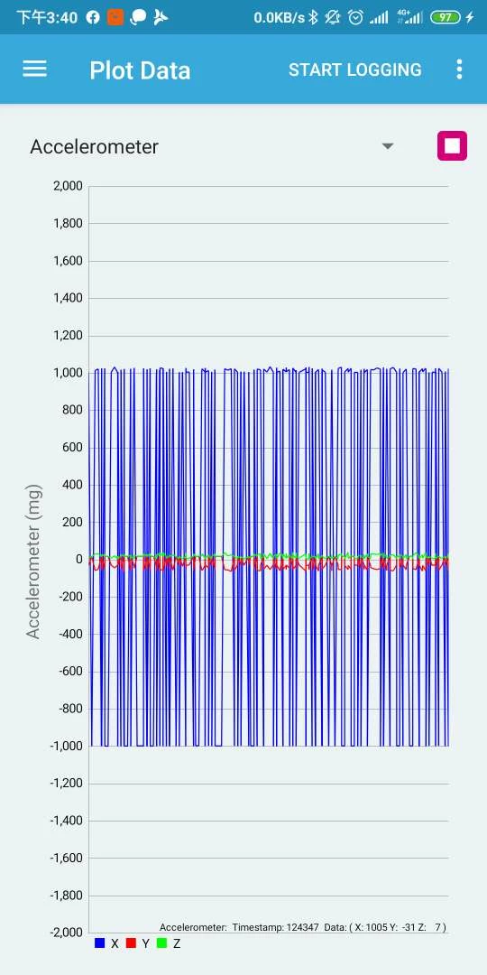

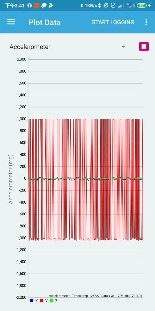

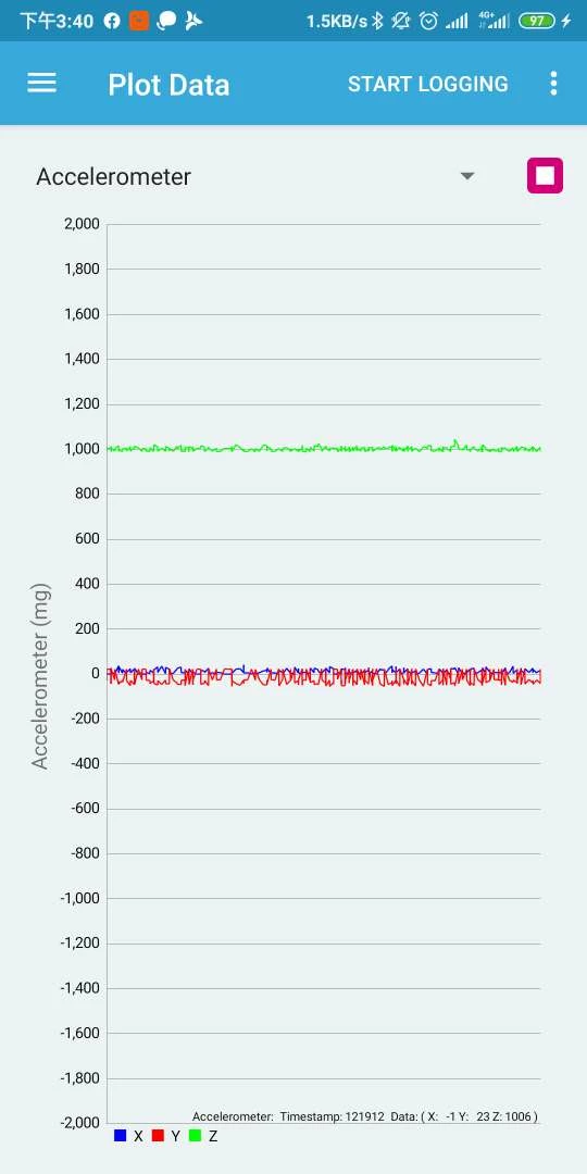

Strange G value?
Hello, I just got a STEVAL-MKSBOX1V1 a few days ago, and had a problem on trying the accelerometer with the ST BLE Sensor APP. When I keep the sensor's Z axis up or down, the APP shows consistent +1g or -1g. However, when I put the sensor's X/Y up or down, it always shows alternately +/- 1g values. Why? Please refer to the following screen shots.0690X00000BxtxFQAR.jpg0690X00000Bxtx0QAB.jpg0690X00000BxtwbQAB.jpg

Hi @BLin.1​ , did you create an app with Expert view? And did you maybe activated more than one "accelerometer" sensor?
You should select only one, differently the graph will show the data from both acceletometers going up and down between -+1g

You are right. After disabling one of the 2 accelerometers, the problem is solved. Thank you.
