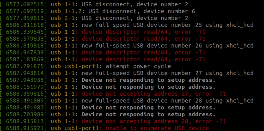

On linux, run "dmesg -w" while uou un- and replug the stlink. If there is any reaction, post here. Otherwise, try another cable and another USB plug on your computer.
FUs.1
FUs.1Author
April 12, 2020
Thank you very much for the prompt reply.
Yes, there has been a reaction. In the picture you can see what happened when I replugged the the hardware. 0693W000000VidJQAS.png
Uwe Bonnes
Chief
April 12, 2020
Stlinkv2 has a fixed pull-up on USB-DP, causing the system to try to reenumerate. The Stlink does not react on the reenumeration requests. Just to be sure: The target board is disconnected? Is yes, I think your STLink is defunct. Did you perhaps wrong wire something and external volatage > 3 Volt or < -1 Volt got applied to the Stlink? This is the only way I killed STM32s. If the target board is still connected, retry with the target board disconnected
