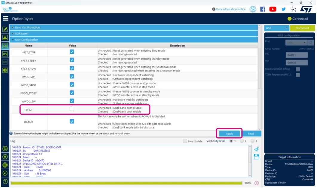

If this is not the case, the binary may have been flashed to the wrong flash bank. The STM32L4+ microcontroller supports double-bank flash memory. Moreover, two different firmware images can be downloaded separately, one for each bank, and the boot bank is controlled through the STM32 option bytes. Please use STM32CubeProgrammer to check the option byte configuration. The default configuration should have the BFB2 field unchecked (for STWIN), and the binary should be flashed at address 0x08000000.
You can refer to DATALOG2 User Manual chapter 2.1 (this section is also valid for DATALOG1 firmware also)

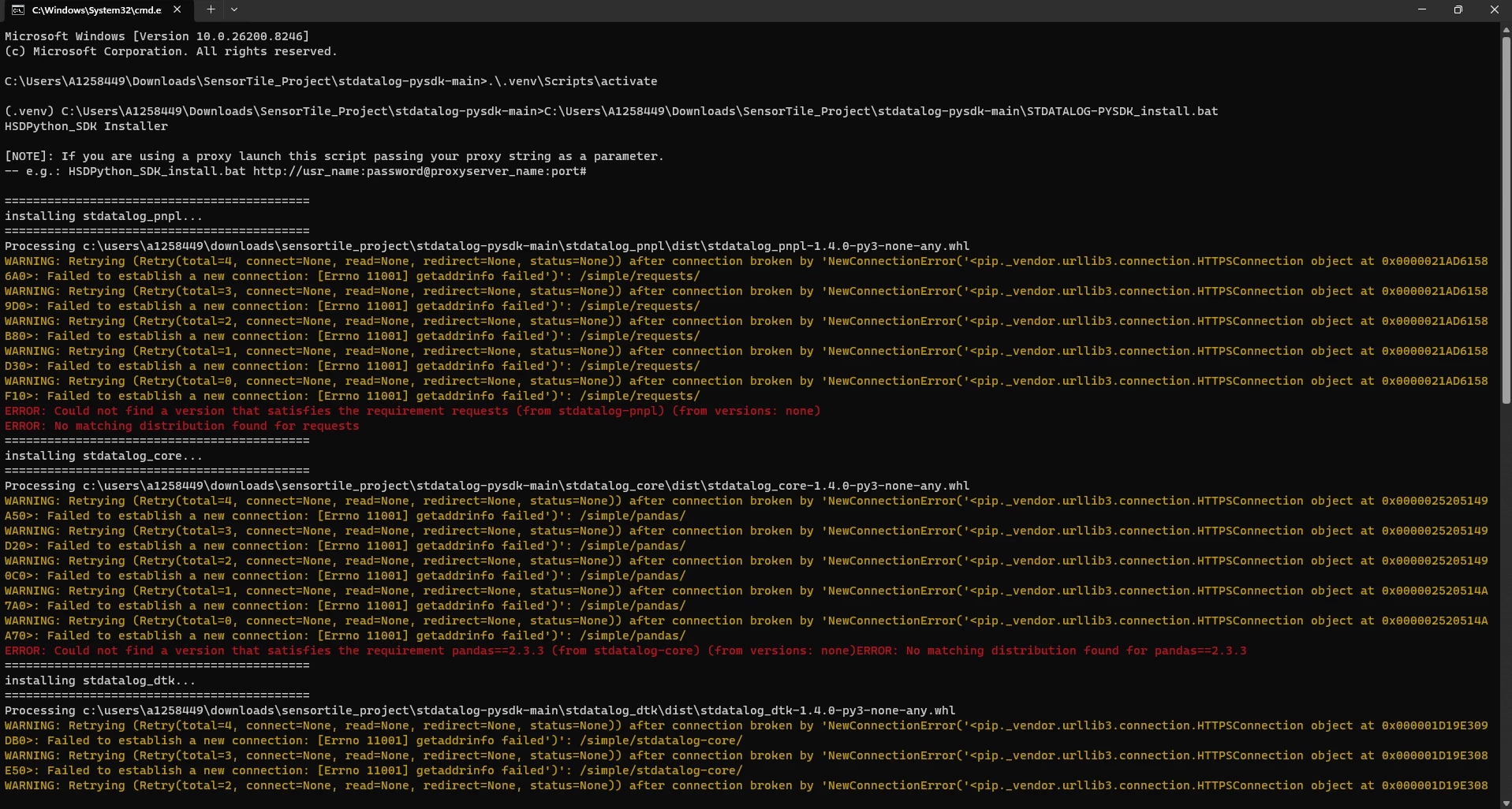

I will be sure to upgrade to the DATALOG2 + PYSDK. I tried downloading the PYSDK from Github and ran into some issues when installing. I followed all the steps provided and keep getting these issues. Any idea on what I am doing incorrectly?

Which version of Python are you using? The installer automatically downloads some packages, so your PC must be connected to the internet. Are you using a proxy? Do you have some antivirus/firewall?
Please launch the installer from the command line, as described in the [NOTE] section. The errors you are seeing indicate that PYSDK has not been installed correctly, so it can’t work.
