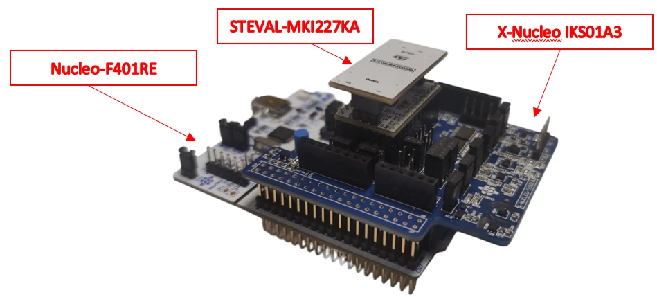

STEVAL-MKI227KA connected using DIL24 on X-Nucleo IKS01A3 with STM32F401 Motherboard not detected

I am using a STEVAL-MKI227KA on the expansion board IKS01A3 because I saw on the datasheet that it is compatible. The expansion board is connected to a Nucleo-F401RE Motherboard. Why I am using that and not a MKI109B3 motherboard is because I want to be able to use AlgoBuilder.

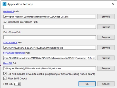

On AlgoBuilder, I entered the various locations of the softwares it uses on my case :
Under AlgoBuilder, I enter the various locations of the software it uses in this case.Djokhar_1-1695893169033.png
I also placed the jumper where it should be, to be able to use DIL24 connected sensors.

To verify if it's indeed the accelerometer of the LSM6DSV16X sensor on the STEVAL-MKI227KA Kit board, I disconnect it:
Even though the board is disconnected, I still collect accelerometer data, leading me to conclude that AlgoBuilder has selected the accelerometer on the IKS01A3 board. This is despite the correct jumper being in place. I've also tried removing the jumpers corresponding to the onboard sensors of the IKS01A3 board, but in this case, no data is available even though the STEVAL-MKI227KA kit is connected.
