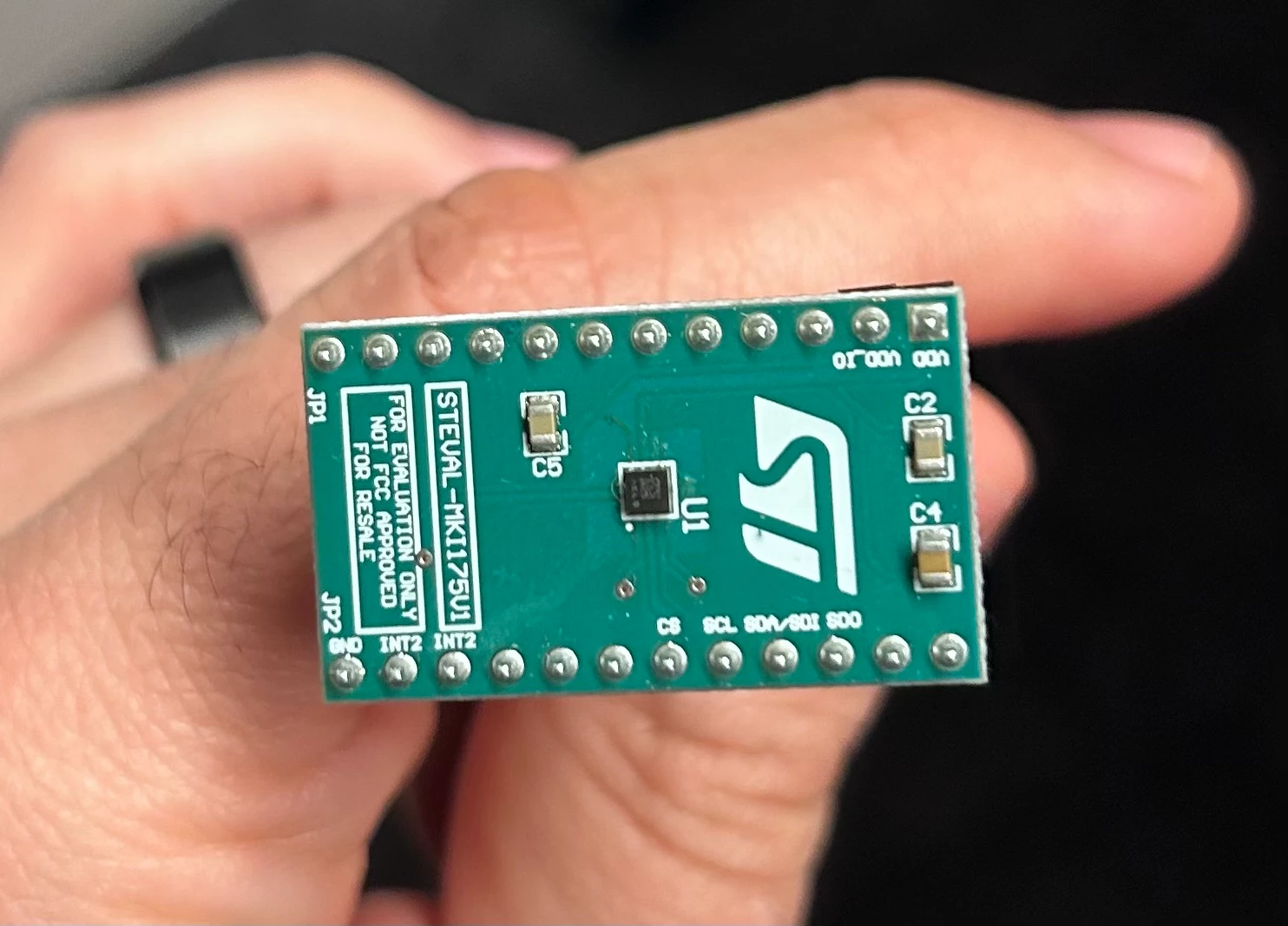

STEVAL-MKI175V1 showing incorrect INT reference in PCB
  • December 4, 2023
  • 1 reply
  • 2032 views
I noticed that INT2 is repeated in 2 pins so it confuses to identify which is INT1 and INT2. Please consider change it for future production.
Regards,
Pascal.
Best answer by liaifat85
Yes. The datasheet says JP2 pin 14 is INT1 and 15 is INT2. The printing on the top silk needs a correction.
