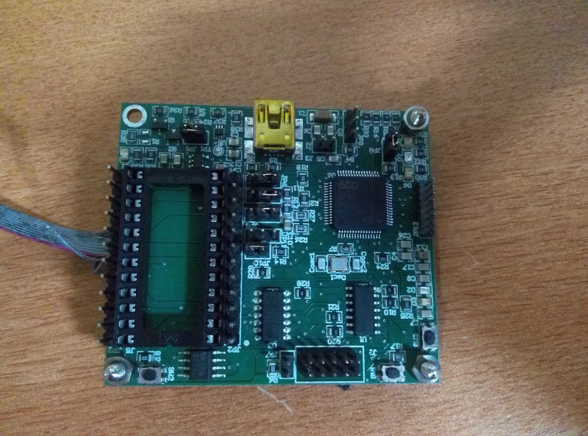

Hi I am using, ST eval (STEVALI109V2),suddenly its not working,its not giving usb port ,when i connected to PC, D1 & D5 LED are blinking,please guide me ,how to fix it.

    part number of board - STEVAL - MKI109V20690X000006C9NZQA0.jpg0690X000006C9NUQA0.jpg

    Didn't you try to update the firmware?
    chaitanya chippada
    October 24, 2018
    I don't know how to update firmware for STEVAL-MKI109V2 ,can you guide me, how to update firmware ?

    October 24, 2018
    Please donwload STSW-MKI109W and follow DFU User Guide located in DFU directory.
    https://www.st.com/content/st_com/en/products/embedded-software/evaluation-tool-software/stsw-mki109w.html
