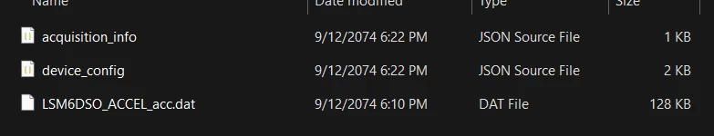

Federica Bossi
Sep 14, 2026 9:10 AM UTC
Hi ​@Aakash_2910 ,
You can try reflashing the latest firmware available.
Are you using MEMS Studio?

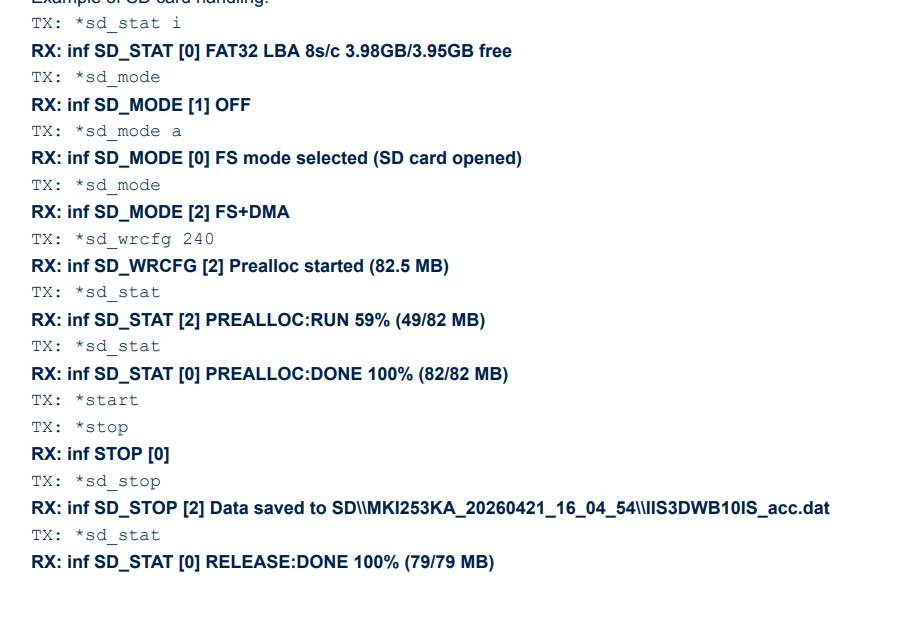

Sep 15, 2026 8:19 AM UTC
Yes i am using MEMS software only.
Sending the commands via
sending these commands only
Federica Bossi
Federica BossiBest answer
Sep 22, 2026 7:25 AM UTC
Hi ​@Aakash_2910 ,
Saving data to the SD card in Datalog-2 format is supported only for the IIS3DWB10IS sensor (MKI253KA).
