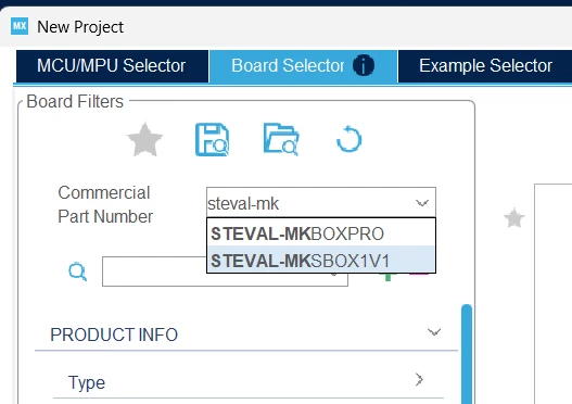

In the stm32 cubeMX Board selector menu I cant find board MKI-109D.
How can I develop the board firmware?

The STEVAL-MKI109D is not exposed as a standard CubeMX board target for custom application firmware development. It is primarily intended as an evaluation motherboard / bridge platform for MEMS sensor daughterboards.

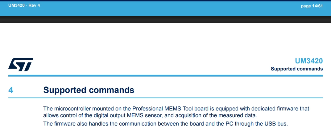

I’m not sure that the STEVAL-MKI109D is really intended for user firmware development?
It seems to me that the main idea is to use MEMS-Studio to do that:
https://www.st.com/resource/en/product_presentation/steval-mki109d-quick-start-guide.pdf
See also:
https://www.st.com/resource/en/user_manual/um3420-stevalmki109d-professional-mems-tool-motherboard-for-mems-adapter-boards-stmicroelectronics.pdf#page=15
If your goal is to evaluate the sensor and verify the communication path, the recommended workflow is to use MEMS Studio rather than starting from a bare CubeMX board project. MEMS Studio is designed to talk to the board using the ST-provided bridge firmware and gives access to:
  • sensor register read/write
  • WHO_AM_I verification
  • ODR / full-scale configuration
  • FIFO control and data logging
  • interrupt / pin configuration
  • live sensor plotting and acquisition
