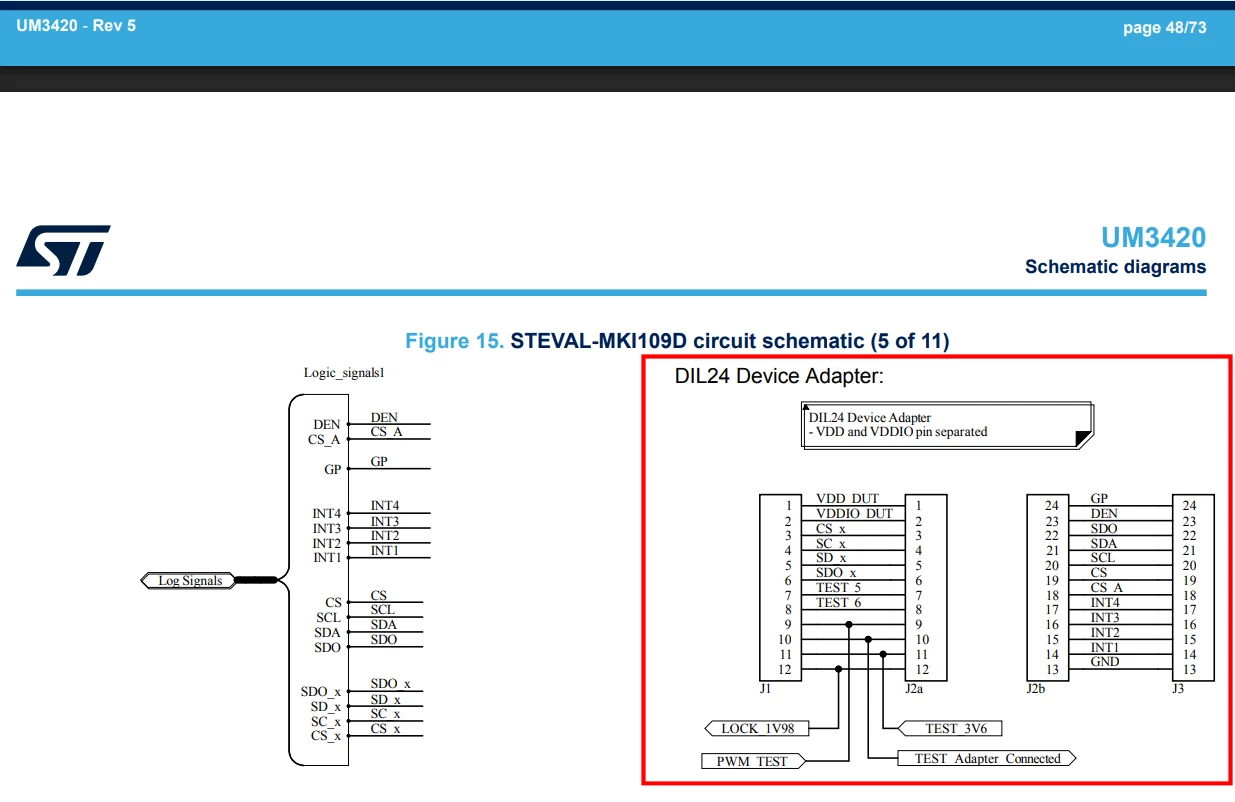

Hardware: STEVAL-MKI109D (STM32H563ZI), ISM330DHCX on DIL24
I'm developing custom bare-metal firmware for the STEVAL-MKI109D motherboard (STM32H563ZI), flashed via DFU, to communicate directly with an ISM330DHCX sensor on a STEVAL-MKI207V1 DIL24 adapter — not going through MEMS Studio.
Problem:
I can't get a valid SPI response from the sensor — WHO_AM_I consistently reads back as 0xFF. I've verified the following are correct against the ISM330DHCX datasheet:
  • GPIO alternate function mapping (AF5, SPI1) confirmed via register dump
  • SPI1 configuration matches Mode 3 (CPOL=1, CPHA=1), master mode, 8-bit frames, software NSS
  • Read command format (0x80 | reg + dummy byte) and HAL_SPI_TransmitReceive sequence match the datasheet's read protocol
The sensor and DIL24 socket are confirmed good — sending the stock firmware's power-on/voltage-set commands over the same UART interface correctly reads WHO_AM_I = 0x6B.
I'm currently using PA4/PA5/PA6/PA7 for SPI1 CS/SCK/MISO/MOSI in my firmware, but I suspect these may not be the correct pins for the DIL24 socket's SPI bus on this specific board — possibly conflicting with the pins used for the software-adjustable VDD/VDDIO supply.

As always, schematics will be found on the board’s Product Page - see the ‘CAD Resources’ tab:
https://www.st.com/en/evaluation-tools/steval-mki109d.html#cad-resources
In this case, they are also in the User Manual:
https://www.st.com/resource/en/user_manual/um3420-stevalmki109d-professional-mems-tool-motherboard-for-mems-adapter-boards-stmicroelectronics.pdf#page=49
via: https://www.st.com/en/evaluation-tools/steval-mki109d.html#documentation

Jul 2, 2026 3:42 AM UTC
Thanks, this confirms SPI1_SCK/MISO/MOSI/NSS feed the DIL24 socket via level shifters (T14/T15), separate from the Vdd_set/VddIO_set nets — that resolves my main confusion. One remaining question: can you confirm the exact GPIO pin for SPI1_NSS? I can see SCK/MISO/MOSI clearly correspond to PB3/PB4/PB5 based on the NTRST/PB4 pin-share convention, but the NSS routing isn't clear from the schematic text extraction.
pooja_gAuthor
Jul 3, 2026 5:34 AM UTC
Update: went with PA15 for SPI1_NSS (AF5 candidates were PA4/PA15/PG10; PA4 was already ruled out as DAC1_OUT1/Vdd_set, so PA15 was the remaining option). Confirmed correct in silicon via GPIOA MODER/ODR register dumps — happy to share if useful for anyone else hitting this.
