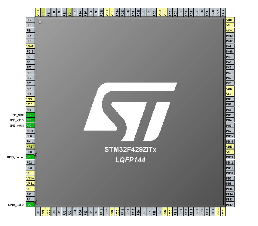

    I already have cube MX. and I generated start code (like configuring SPI5, Clock and GPIO) done using CubeMX. I am new to st micro controllers(only have some experience with AVR). I don't wanna use L3GD20 driver that come with example project. Because I wanna know how to use the Sensor only by using HAL API to send and receive data, that way I will get an idea to use other sensors that doesn't have library.

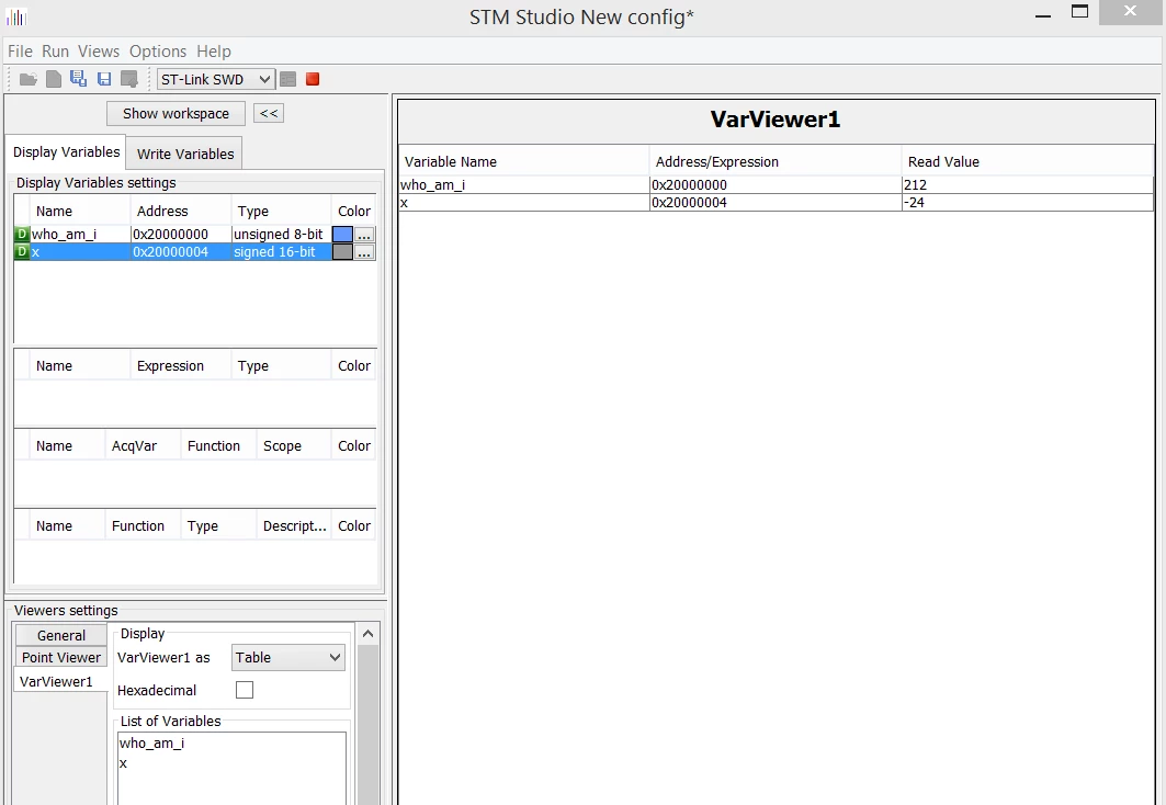

    I don't have a oscilloscope, but i have captured the value of x and WHO_AM_I register using STMStudio

    who_am_i is a uint8_t variable declared globally and the value I got from STM studio is 212(0xD4) comparing with data sheet it's the correct value. right??
    But one thing I noticed is, value of x is changing after every reset.
    Following are the screen shots of value of x after each reset (Board is not moved)
    After reset even if I move the board, value is not changing

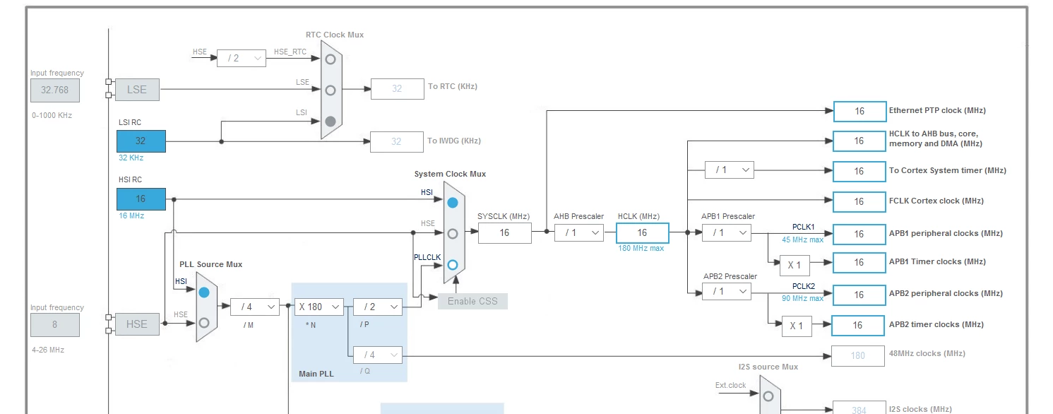

    When generating code using cube MX, I have used HSI as clock source and all peripherals are running at 16 MHz. Would this cause any issue?
