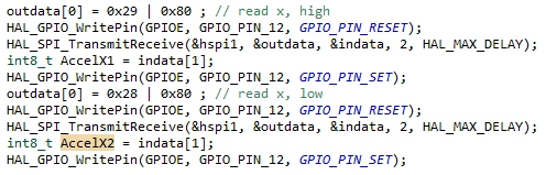

Hi, I created a SensorTile.box project in STM32CubeIDE in which I am receiving the acceleration data from the LSM6DSOX accelerometer. I would like to convert the data I receive from the sensor into the [mg] unit in the same way it is converted in the Data recorder app which you can download on to the SensorTile.box when using the ST BLE Sensor app. Thats why I am wondering if there is any Project code for the Data recorder app, where I could see how the calculation is performed. (I require the same kind of data because I have taught a machine learning model on data received from using the Data recorder app)
I have set the accelerometer to work at 104 Hz and 4g. My current calculation of accelerometer data is based off of the code I found in the SensorTileBox-BLESensors project from the FP-SNS-STBOX1 function pack. Here is the code (for the X axis, Y and Z are also calculated like X) I am using to get the acceleration data and convert it to the [mg] unit:
For instance the data I received from the app while the SensorTile.box was stationary, was around 993 mg on the Z axis. When I used my own project and the SensorTile.box was in the same position, the data was around 960 mg on the Z axis. That is why I am assuming that I am not converting the data correctly.

Hi @Bxy ,
Lookig at your code, you write:
the correct form should be:
int16_t     AccelX;
int32_t      AccelX_mg:
AccelX= ((int16)AccelX1 <<8 ) | AccelX2);
AccelX_mg= (int32_t)((float)AccelX * LSM6DSOX_ACC_SENSITIVITY_FS_4G);

Jun 19, 2023 7:57 PM UTC
Thank you, I seem to be getting just about the same values now.

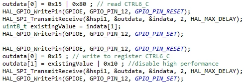

Before I accept the solution I would like to also ask if you know what settings are being used on the LSM6DSOX (which values are being sent to which registers to set up the accelerometer), when I choose to use the Data recorder app from the ST BLE Sensor app. The settings in the Data recorder app for the IMU Accelerometer sensor are: 0 minutes Acquisition Time, Low power Power mode, 104 Hz ODR and 4 g FS.
Because currently, I am just setting the accelerometer to 104 Hz ODR and 4 g FS as such ( in the CTRL1_XL register):
I would also guess that Low power Power mode means disabling high-performance operating mode in the CTRL6_C register like this:
So I would appreciate it a lot if you could tell me how the LSM6DSOX is being set up when using the app. Again thank you very much for your help.

Ciao @Bxy ,
The settings you use are the same of the app, because the fw performs the same operations.
The only difference could be in the ODR: the setting for the sensor is the same (write 0x48 in register 0x10) but for some ODRs the timer at which the data is read/written is slightly different (for example it could be 100 instead of 104)
If this difference is important to you I can check with the dedicated team and let you know.
