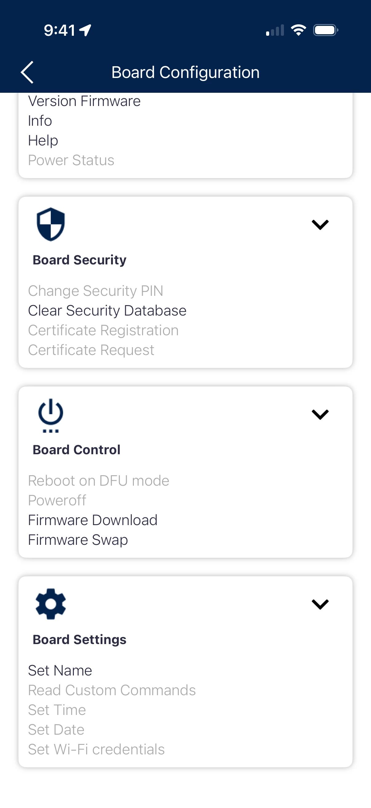

Hi, I’m running the ST BLE Sensor app on an iPhone and when I attempt to change the profile from beginner to expert, it does not take. The result is that many options are grayed out. Am I doing something wrong? Is there a work-around? I don’t have access to an Android device.
iPhone 16-Pro iOS 26.62, APP v5.2.6, fp-sns-datalog2 v3.3.0, STEVAL-STWINBX1
Thanks, Tony

CrigstarAuthor
Oct 2, 2026 5:54 PM UTC
Ahh, so it has the Beginner box checked even though you are or may be in Expert?
I captured the options before and after setting Expert, and also deleted the app and set Expert as the initial configuration, and all three screens have the same grayed out options (attached). I did ask this in another category and it sounds as if it’s a known issue and is being worked on.

Federica Bossi
Oct 6, 2026 12:38 PM UTC
Hi ​@Crigstar ,
Yes, currently the Beginner box is checked by default even though you are or may be in Expert when you want to change the profile.
The gray options that you are showing in the screenshot are correct because this options are not available in the firmware.

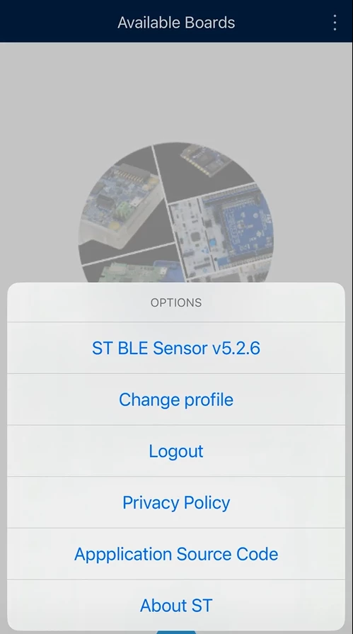

Hello ​@Crigstar
I’m sorry, I misunderstood your original request started here:
The known issue refers to a specific bug: while setting the Expert mode, you should enable some advanced features in the options menu (3 dots in the upper-right corner). Unfortunately, in this version the menu doesn’t change. Both in Beginner and Expert mode you should see the very same content I’m sharing here:
This is the issue I was referring originally: when the next maintenance release will be available some further options will appear in this menu.

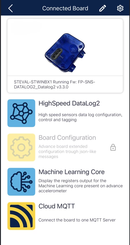

The unique demo that is not available in Beginner Mode is the Board Configuration. Here the expected view in Beginner Mode

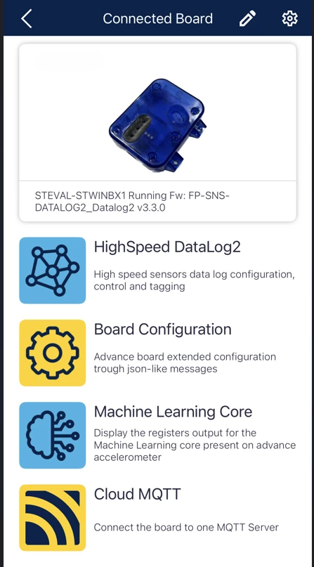

Here instead the view in Expert Mode
Board Configuration is the view you shared before. So, you’re setting Expert Mode correctly. It’s a generic demo used by different firmware from ST. DATALOG2 is not exposing all those features by design. In general, a firmware using BLESensor app can use and expose each of those commands freely; we’re providing firmware demo that implements all the commands and others that implements only a subset as we’re doing in DATALOG2.
