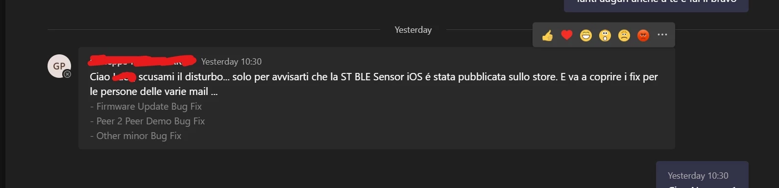

Eleon BORLINI
January 4, 2022
Hi @MSchl.3​ ,
just a message from yesterday:
0693W00000HqUcRQAV.jpgLet me please know if now it works!
-Eleon

Hi Eleon,
yes, thanks, the update showed up yesterday in the AppStore, now it works again!
