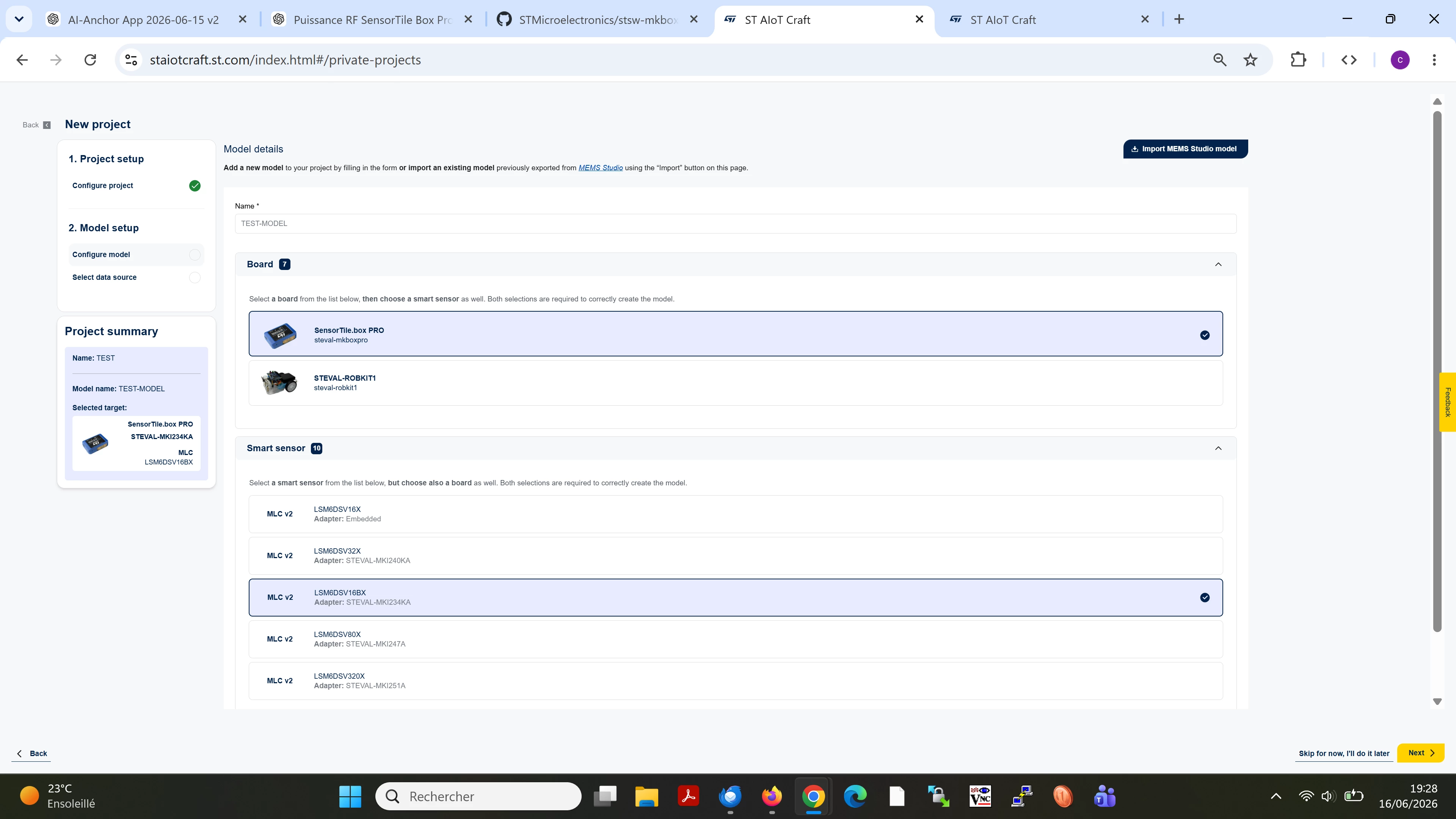

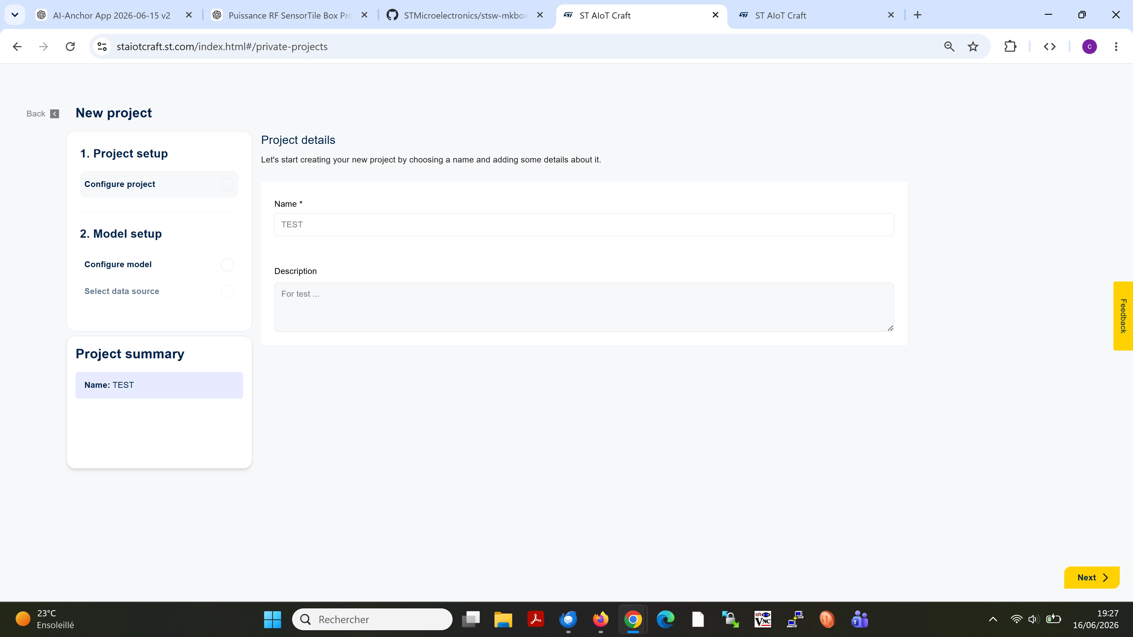

Hello.
I would like to use ST AIoT Craft with a SensorTile Box Pro and the MKI234AA DIL24 board to have an external LSM6DSV16BX IMU (different from the onboard LSM6DSV16X).
Six months ago, in December 2025, the accelerometer and gyroscope data logging from the LSM6DSV16BX was visible in the ST AIoT Craft interface, and I was able to collect data successfully.
Today, I can no longer select the LSM6DSV16BX device because it is no longer visible in the available sensor choices. As a result, I am no longer able to collect data from it.
I find this situation rather surprising, and I understand that ST AIoT Craft has evolved since the version I was using in December 2025.
However, when creating a new project, it is still possible to select the SensorTile Box Pro and then choose the external board STEVAL-MKI234KA. The issue is that during the data logging phase, the LSM6DSV16BX sensor never appears among the available sensors, making it impossible to collect accelerometer and gyroscope data from this device.
Could you please provide more information on this topic?

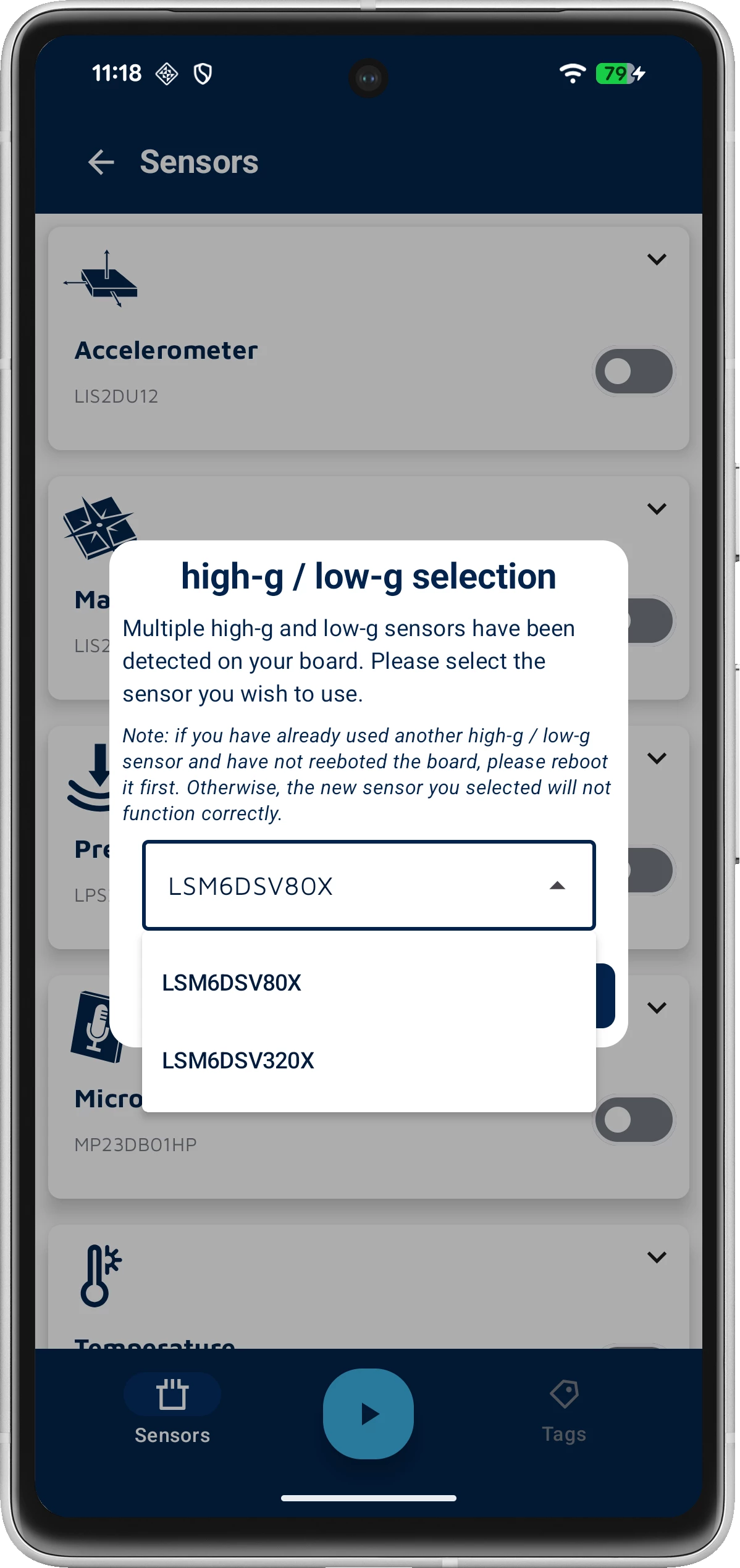

dufazaAuthor
Jun 14, 2026 2:36 PM UTC
This kind of window is not available for me in iOs ST AIoT Craft app … same problem ?

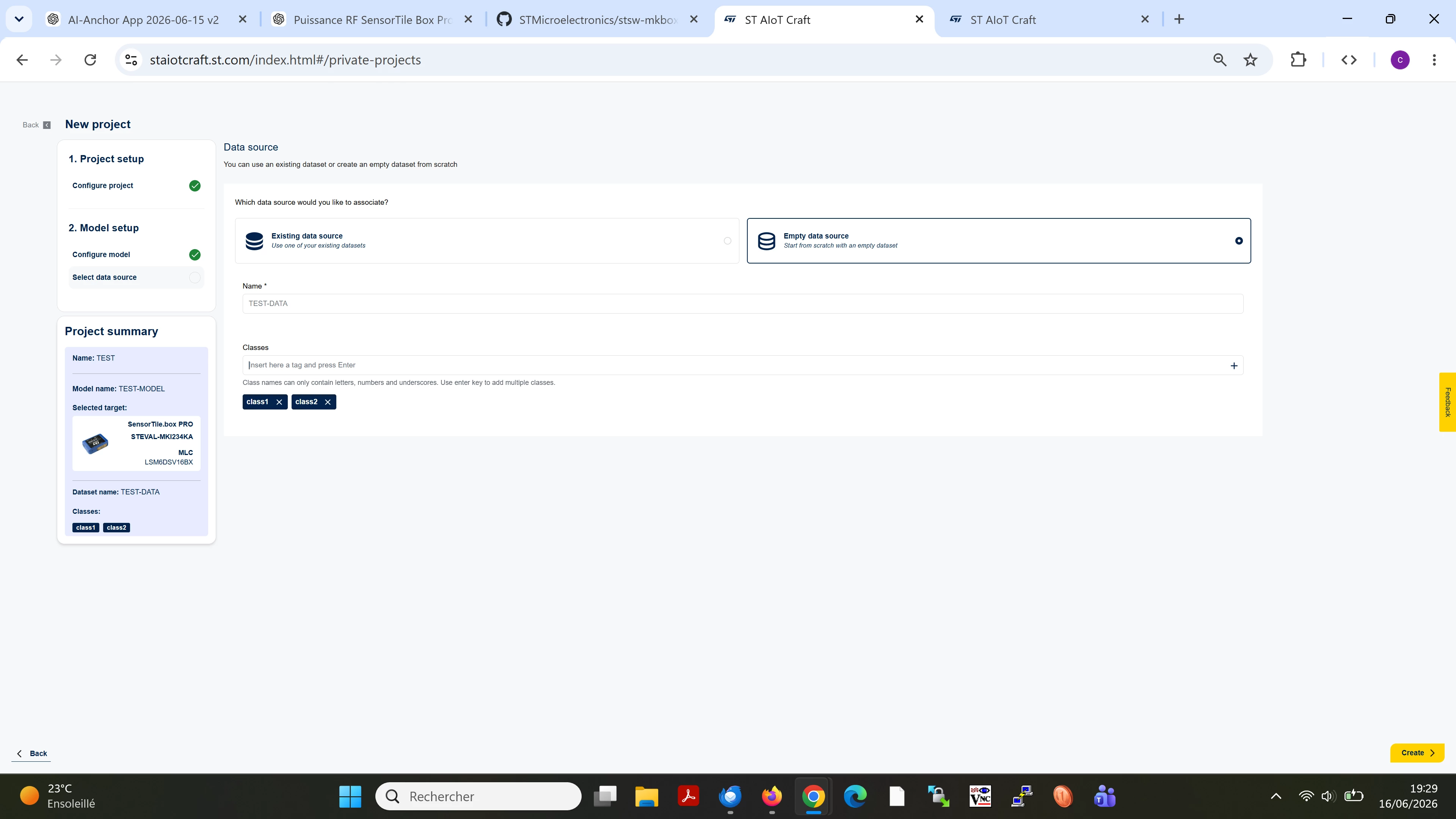

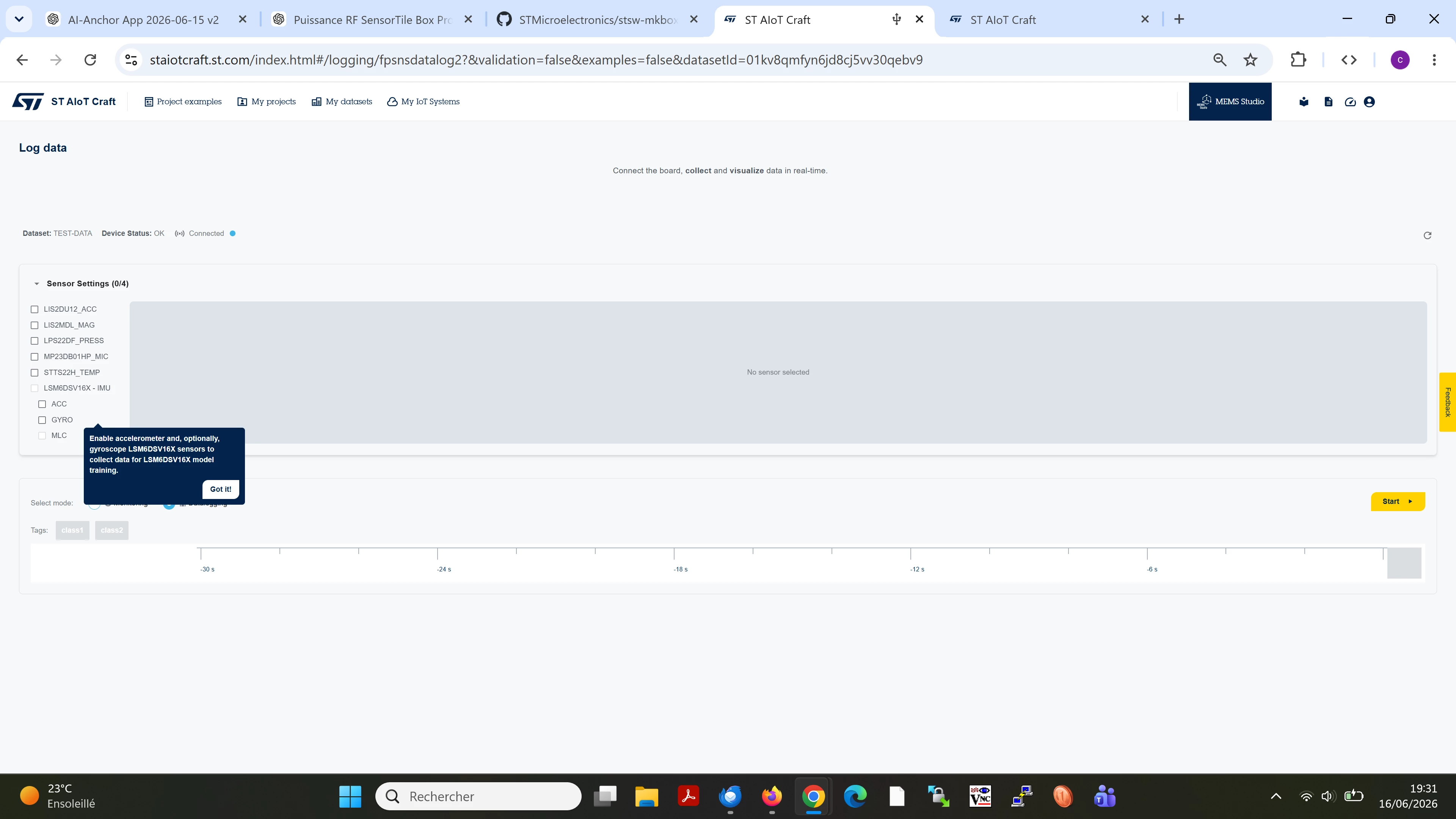

Jun 16, 2026 5:46 PM UTC
Hello and thanks for your response.
I’m using SensorTile BoxPro with DIL24 MKI234KA (LSM6DSV16BX).
FW version of Datalog2 3.2.0 flashed on my BoxPro.
Create a new project, new model, new dataset from scratch.
Cannot see the LSM6DSV16BX when started datalogging (see image).
Thanks
Jana SCUKOVA
Jana SCUKOVABest answer
Jun 17, 2026 9:38 AM UTC

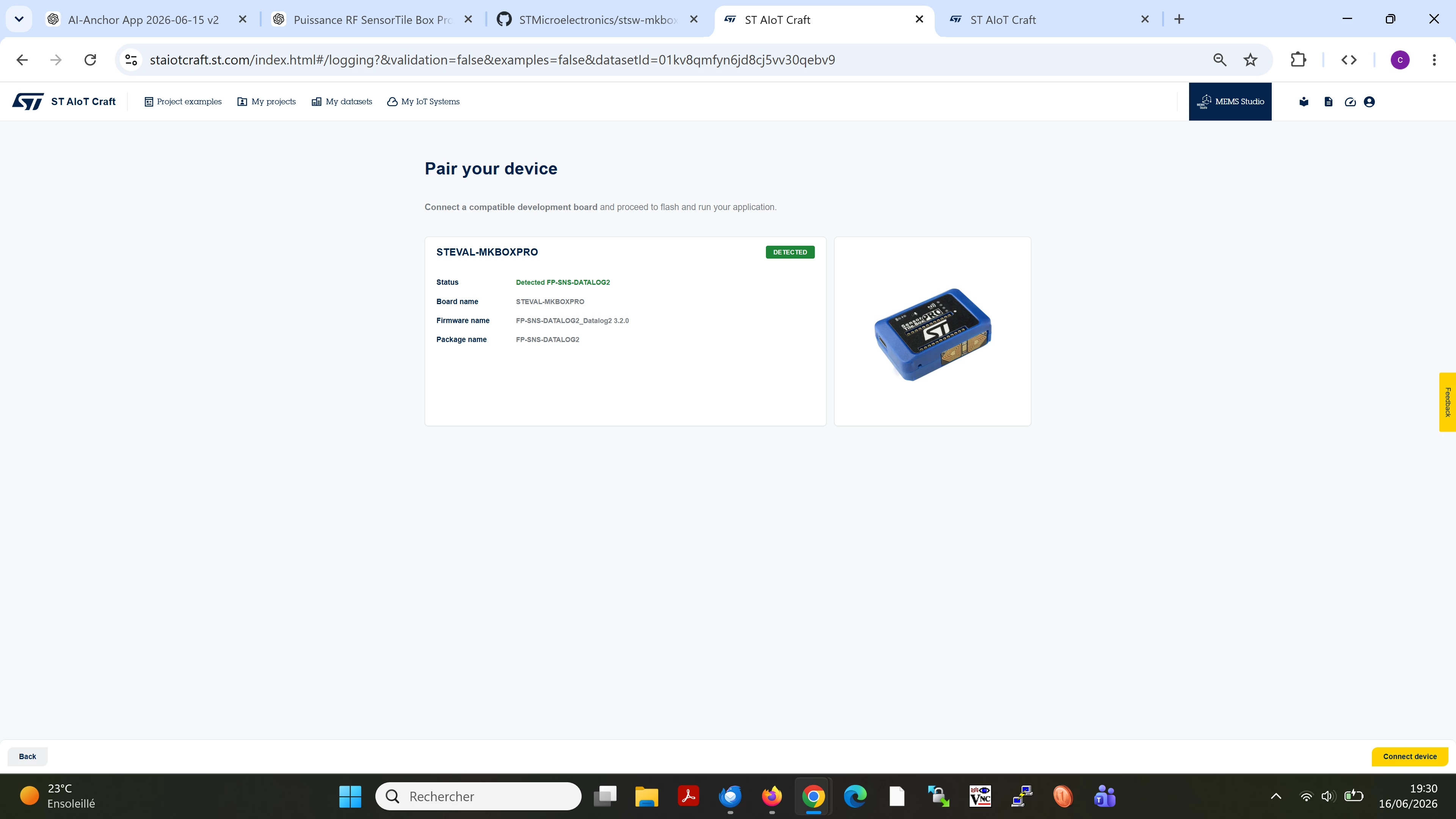

Hello ​@dufaza
Please confirm that you are following these instructions:
  1. Push the DIL24 adapter on the SensorTile.box Pro board while the board is switched off and not connected to the PC. Please check the proper orientation of the DIL24 adapter.
  2. Connect the SensorTile.box Pro to the PC and switch it on.
  3. Open the relevant dataset in ST AIoT Craft.
  4. Click “Log new data” button
  5. If necessary, update the firmware
  6. If necessary, pair your device
  7. Connect the device
  8. The “Log data” page opens, and LSM6DSV16BX is still not listed
Thank you.
dufazaAuthor
Jun 17, 2026 11:01 AM UTC
Hello Jana,
yes i confirm all the procedure.
But, at this time, i suspect that my MKI234KA is out (i don’t know the reasons and/or the history)
So, next monday, i will receive new sample of MKI234KA and i will be able to test it again.
Of course, i’ll keep you informed.
Thanks for your help
