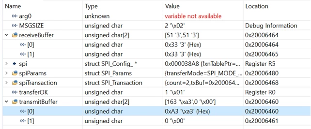

I'm using the LaunchPad CC2642R1/CC2652R1 with the accelerometer LIS2DH and i tested the "who am i" (0x33) register to validate the protocol but when i tried read another register i had the same response that "who am i" (0x33) register. Could you help me with this problem or give me some ideas to solve it?
How can i set up the accelerometer? I can't read any register other than who am i (this register is shows in each reading).
0693W00000Y8yEeQAJ.pngThank you in advance.

Hi KnarfB,
This is my code:
//Register
#define WHO_AM_I_ACELEROMETER (0x0F)
#define WHO_AM_I_R (0x33)
#define Read (0x80)

Is CS asserted as shown in the data sheet?
In the above debug window, transmitBuffer[0] shows 0xA3 which is different from what I would expect from the code?
Hook up a cheap logic analyzer and watch the waveforms if you can.
hth
KnarfB
TVela.1
TVela.1Author
January 24, 2023
Yes, i'm using cs as "0" and 0xA3 is the register that i'm reading (0x23) with the bit to read (0x80, this is part of the protocol).
My issue is with receiveBuffer. I'm receiving the same data every time "who am i" register.
Regards,
Tania

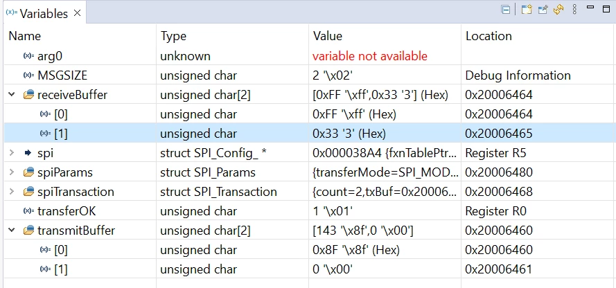

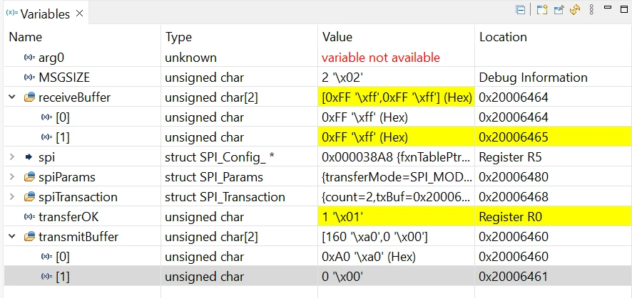

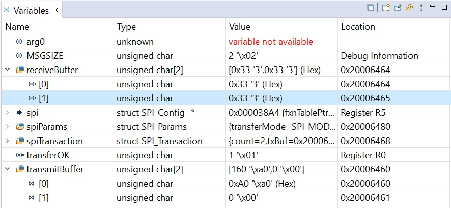

I'm using the STEVAL-MKI135V1 board with just the next connections:
  • MOSI to SDA
  • MISO to SDO
  • CLK to CLK
  • CS to "Low" "0"
  • ADC1, ADC2 and ADC3 to GND
  • VDD to 3.3V
  • VDD_IO to 3.3V
I got the following response when I was trying to read the CTRL_REG1 in first place (it's the same case with others register).
Step 1: Read "CTRL_REG1"
0693W00000Y94SIQAZ.pngIt only receives 0x33 from the "who am i" register when it is the first register read but when I try another register later the register "who am i" the following responses were obtained:
Step 1: Read "WHO_AM_I"
0693W00000Y94UnQAJ.pngStep 2: Read "CTRL_REG1"
KnarfB
KnarfBBest answer
January 25, 2023
> CS to "Low" "0"
Hard wired low? Think (don't have your hardware) you need to toggle it for each new SPI transfer. Otherwise you end up in the "Multiple bytes SPI read protocol", see Figure 8 of the data sheet. And, since MS bit is not set, you are reading the same reg over and over again.
hth
KnarfB
TVela.1
TVela.1Author
February 10, 2023
Hi KnarfB,
Sorry for the delay. Toggle it was the solution.
Thank you for your help.
