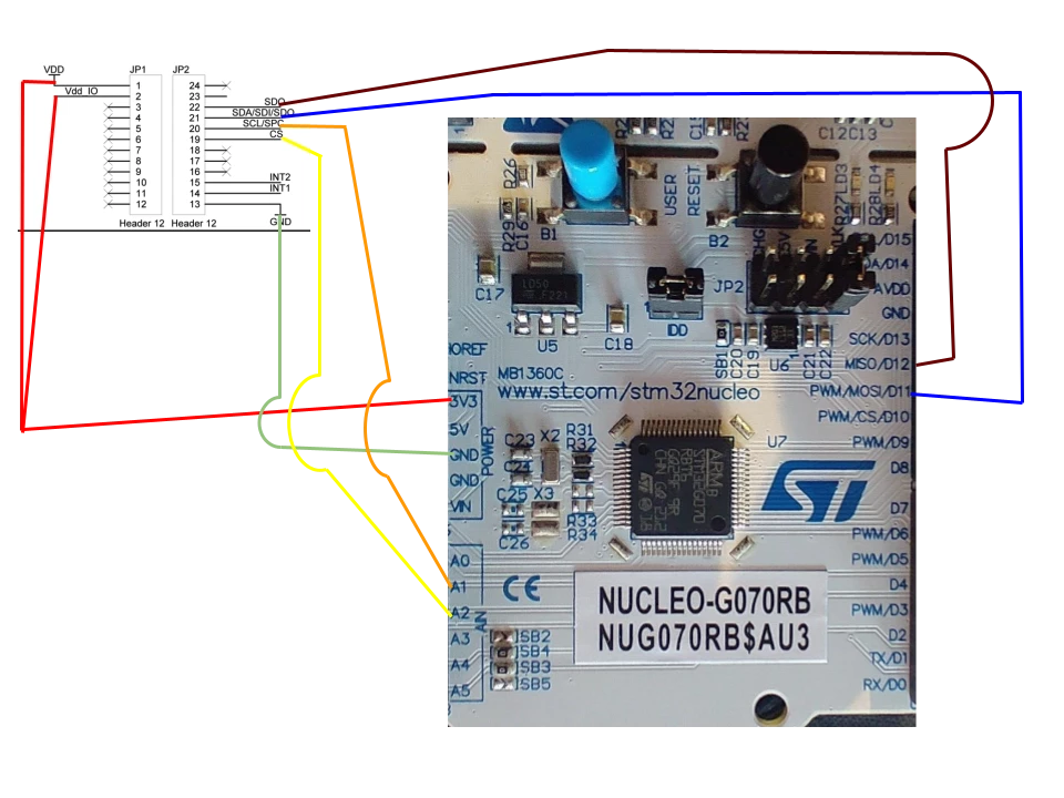

I'm trying to get an accelerometer connected to my Nucleo-g070RB. I've got the STEVAL-MKI164V1 board with a LIS2HH12 on it.
The problem I have is I always get either zero of 0xFF when try to read the device ID (WhoAmI) which is not correct.
The 2 boards are wired up as:
+3.3V ------- Vdd
+3.3V ------- Vdd_IO
Ground ------ Ground
PA6 --------- JP2(22) SDO
PA7 --------- JP2(21) SDA/SDI/SDO
PA1 --------- JP2(20) SCL/SPC
PA4 --------- JP2(19) CS

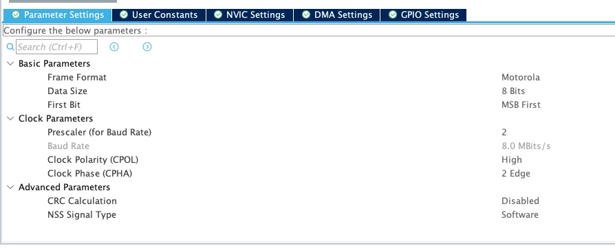

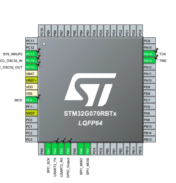

From my .ioc file I've configured things as follows
Data Size : 8bits
First Bit: MSB First
CPOL: High
CPHA: 2 Edge

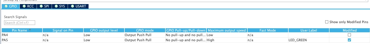

Also I've configured PA4 as a digital output to use for CS
I found another post in this forum indicating these settings are correct LIS2HH12 does not respond on SPI
Initially I thought that CPHA should have been on 1 Edge. With this setting change I get FF every time instead of the first few samples.

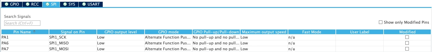

The GPIO settings from the .ioc file look like this
Screenshot 2023-10-20 at 12.42.08 PM.pngScreenshot 2023-10-20 at 12.42.01 PM.png

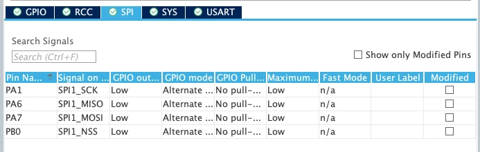

I've also tried a version where I connect CS to PB0 and select Hardware NSS Output Signal
Which gives me SPI GPIO configuration that looks like this

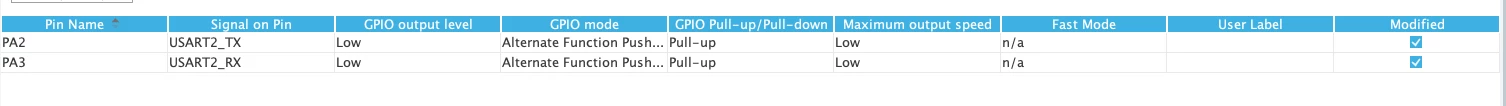

Hi @marchold ,
The connections are correct, but in NUCLEO-G070RB PA2 (SPI1MOSI) is connected to UART2_TX. this pin is connected to STLINK section. Could you verify it?
If this helps you, please mark my answer as "Best Answer" by clicking on the "Accept as Solution" button, this can be helpful for Community users to find this solution faster.
marcholdAuthor
October 23, 2023
Thank you for your reply.
I don't think the PA2 which is connected to the UART2_TX was related to the problem since MOSI in this case is PA7.
I believe the problem was related to the platform read code needed to set the MSB to 1. Adding Reg |= 80 allowed me to get the correct device ID.

I ended up getting a logic analyzer and found this post SPI MISO line stays high? to be helpful. That post was indicating that the problem was on the sensor side since everything else looked correct but the MISO line was just stying high and it did not matter if I was even connected to the sensor board. In the documentation in section 6.2.1 it says
bit 0: RW bit. When 0, the data DI(7:0) is written into the device. When 1, the data DO(7:0) from the device is read. In latter case, the chip will drive SDO at the start of bit 8.
which tipped me off to the problem.
