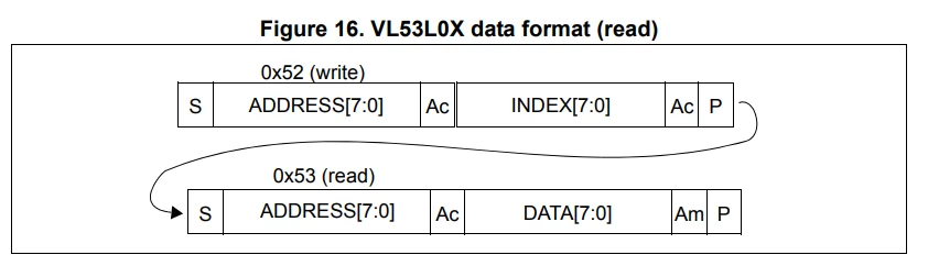

I implemented the VL53L0X API in my embedded project. while the call to DataInit works fine (or, at least returns a status OK), I am getting a VL53L0X_ERROR_REF_SPAD_INIT from StaticInit.

Hi, I'm facing the same issue, I tracked the error to the enable_ref_spads() function. The comparison between the written and read map is throwing a VL53L0X_ERROR_REF_SPAD_INIT error. It seems like the write operation of the SPAD map isn't taken into account by the sensor even if the I²C dialog is working fine...

Hello ! I found the solution to my problem. It simply came from a bad implementation of the platform VL53L0X_WriteMulti(...). I was issuing a new start condition after writing the index... Now everything is working !

tobajer
Visitor II
April 4, 2019
Hi, your VL53L0X_read_multi is wrong. Take a look on datasheet:0690X0000089wL2QAI.png
You should send an address WRITE followed by command (index) and stop P transmission. Then start S transmission reading the data.

Nevertheless I have the same problem with VL53L0X "error to the enable_ref_spads() function". I still didn't find a solution to this problem.
Before I used the same piece of VL53 by ARDUINO and it runs smoothly w/o any problems. So I know the hardware is OK. Any idea what can be wrong?

ms1802
May 26, 2019
Below is a working version.
It passes the above verification code ftom ST and I get measurement data from the sensor!
(original code it taken from the net - lost the reference to the original author - sorry!)
But, there was a bug in the original version wrt to the VL53L0X_write_multi - it did not work!
Theo's note - put me onto the right track.
