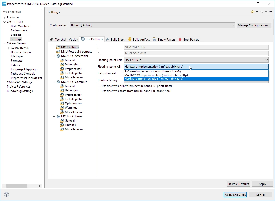

    Here are the 2 lines of errors I see after adding the X-CUBE-MEMS1 MC and EC libraries and the associated header files...
    c:/program files (x86)/atollic/truestudio for stm32 9.3.0/armtools/bin/../lib/gcc/arm-atollic-eabi/6.3.1/../../../../arm-atollic-eabi/bin/ld.exe: error: LSM9DS1 Driver.elf uses VFP register arguments, ../Middlewares/STM32_Motion_Library/Lib\MotionEC_CM4F_wc32_ot.a(motion_ec.o) does not
    c:/program files (x86)/atollic/truestudio for stm32 9.3.0/armtools/bin/../lib/gcc/arm-atollic-eabi/6.3.1/../../../../arm-atollic-eabi/bin/ld.exe: failed to merge target specific data of file ../Middlewares/STM32_Motion_Library/Lib\MotionEC_CM4F_wc32_ot.a(motion_ec.o)
    January 6, 2020
    Please check the project settings in C Compiler - target - Floating point.
    These should be settings something like "Mixed ..." not Hardware Implementation.
    The libraries are compiled with -mfloat-abi=softfp option .

    So, the error is not truncated. I believe it is saying my code is setup to use VFP registers and the MotionEC code (library) is not. I'm assuming VFP controls the way the ARM registers are used. However, I am not sure what I am looking for in the code. As there are many defines with VFP in the define names (for example: "_TARGET_FPU_VFP", "_ARM_PCS_VFP", "__VFP_FP__", ect).
    January 6, 2020
    Go to project properties and try to find the settings there,
    I don't have Attolic TrueStudio but in STM32CubeIDE it looks like in the attached screenshot.

    Trying something: Under Properties=>C/C++ Build=>Settings=>Tool Settings=>C Compiler=>Target=>Floating point change from "Hardware Implementation" to "Mix HW/SW implementation". Also did the same under Linker (Under Properties=>C/C++ Build=>Settings=>Tool Settings=>C Linker=>Target=>Floating point change from "Hardware Implementation" to "Mix HW/SW implementation"). Now the project compiles! But I am not sure if the code is working as expected yet.
