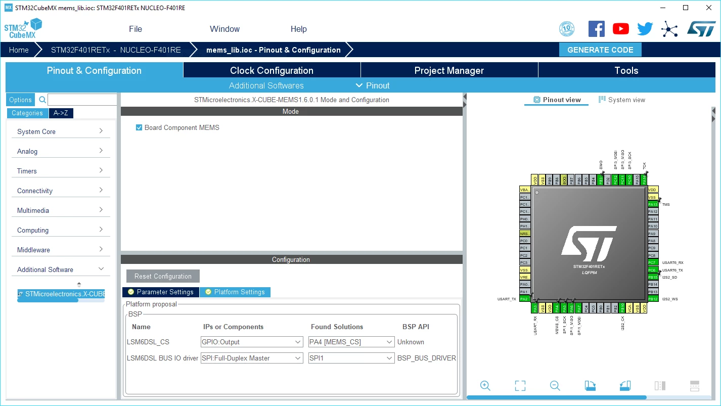

We will test the LSM6DSL for a design update, we would like to get the LSM6DSL of the IKS01A2 working without the BSP code so we can understand what's behind the abstractions layers of the examples.
As far as we understand we should have two LSM6DSL_Object_t instances (one for each IC for the project) and then register the IO Ctx for each of those LSM6DSL_Object_t instances, here is how we do it for one of them:

And then we should be able to use the functions of the LSM6DSL.h file, are we on the right path?
Also, when configuring the sensor on CubeMX it asks me for the Bus to control the MEMS Sensor, it doesn't set up the WriteReg and ReadReg functions with this information?
Kind regards.

Solved, reading the examples and using the BSP support was enough to get it working.
