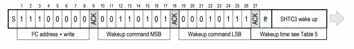

Hello everybody,
I'm working on implementing the driver of shtc3 sensor ( temperature and humidity sensor) with an stm32L152xx microcontroller. I'm using the code example provided by the manufacturer( https://github.com/Sensirion/shtc3-stm-sample-project/tree/master/Source ) but, I replaced I2C functions with HAL functions provided by ST. However, there are some I2C write fucntions into some registers without the data to write which confuses me and I'm not able to make it work or just read the sensor id. Any suggestions or clarifications is more than welcome.

0693W00000DlgkbQAB.jpgI understand what you're saying, I saw it. However, in the folowing picture I don't know what to put in the place of parameter P which is the data to bewritten into the wakeup register
August 31, 2021
P is the I2C stop condition. There are only 3 transaction bytes in the screenshot you posted. After the stop condition, you must wait the SHTC3 wake up time per the table before sending the next command (measurement).
